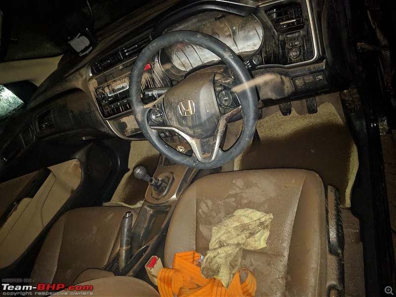

Old 15th October 2017, 10:33   #493
Posts: 14
Default Re: Help! Car submerged in flood
Hello Everyone,
My friends car (Honda City SV Diesel 2014 Model) has submerged in rain water on 13th October 2017 (yes!! 13th the Friday). Water went in and covered at the level of steering wheel. He has a Honda Assure Insurance with addon as zero dep and engine protection. His IDV is 5.81L and car is approximately 3.5 years old with ODO 48750.
He had towed the vehicle to the Honda ASC in flat bed overnight on the same day and He hasn't cranked the engine.
The service advisor has informed him on the procedure and also told him that if engine is not cranked risk is much lowered.
My friend is confused now and needs some advice.
1) Assuming that Engine and Gearbox are safe, if insurance approves the estimate given by the ASC and he gets the car back what would be reliability of the car? Can it be treated as before from reliability perspective? The reason for asking this question are,
a) The entire car will be re-assembled at the ASC now (including SRS module)
b) Water has stayed on floor for atleast 30 hours before its cleaned (might be not dried completely) risk of rusting / structural deformation etc?
c) Will there be any niggles going forward which will make him to run to garage frequently
2) Should he force for total loss? (At the moment he wanted the car back with him and not thinking about total loss)
Also, please advice if he has to take care or be aware of any other things in this situation.
Have got few pics from him and attached the same for a better understanding of what the situation is.
hardilip is online now   Reply With Quote
Old 16th October 2017, 20:47   #494
saket77's Avatar
Join Date: Dec 2012
Location: Ranchi
Posts: 3,189
Thanked: 4,211 Times
Originally Posted by hardilip View Post
Hello Everyone,
Similar situation. You may be interested in this thread: http://www.team-bhp.com/forum/techni...ng-floods.html (Why keyless ignition sucks during floods)
Any modern car with this weightage to electronics is bound to be an expensive repair. Better to push as total loss.
saket77 is offline   (1) Thanks Reply With Quote
Old 16th October 2017, 20:54   #495
Posts: 717
Thanked: 725 Times
Yes, please negotiate for a total loss on this. While there are instances where folks may get their car back working well, I'd suspect the majority of cases isn't a good experience. Sad to see such nice cars getting flooded and going to waste.
Mad Max is offline   Reply With Quote
