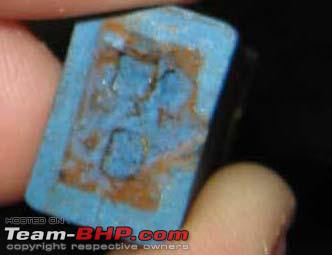

Info needed on a spare part
Have an Indica DLS 2001. Currently with my sister in TN. The mechanic there suggested the replacement of "slow starting sensor". He tells that is needed for maintaining rpm. It is kind of a connector with some wire/strings. For now, he has tied the wire directly.
What exactly is this part. Attaching pic. for reference. It is a small thing, the size of a pen cap.Name:  1.JPG
I am seeing this part for the first time. The part which is needed for mainlining idling rpm is called FICD (Fast Idle Control Device). When the AC is switched ON, this part increases the idling rpm to cope up the additional load on the engine. However the part shown by you in the pictures is nowhere close to FICD. Can you please find out where does this part fit in the engine (which sub assembly)? (A picture might help). We might then be able to get some hint. This to me looks like a solenoid switch. The FICD too has a solenoid switch which is used to actuate the plunger, it could be this part.
Thanks AutoIndian.
If I remember, in 2001 only the DLX came with FICD. Attaching pic showing the location of the part. From the pic, I can see one end going towards the FIP. I have circled the location.

Got the part. It is called slow start sensor connector. Price Rs.90/-
