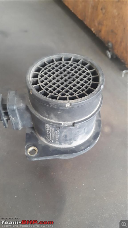

Hi KP, If you can source a MAF sensor cleaner or Electronic component cleaner aerosol spray that is the best option. Aim the tube into the actual sensor block inside and spray!
Else follow this method:
http://www.team-bhp.com/forum/techni...-rs-120-a.html
You can use 100% IPA which is available at medical stores.
Finally, the MAF was cleaned today. DIY work and used IPA.
Post cleaning, the engine revving isn't smooth as before.
Have done only 10kms. Will see how it runs tomorrow.
MAF Casing
MAF sensor inside
Let the car run for some kms as it has to 'learn' the difference post cleaning.
Instant results won't be seen so check after a while.
MAF Casing
Attachment 1382762
MAF sensor inside
Attachment 1382763
Damn that is one dusty MAF! Are you using OEM filter or aftermarket? I wouldn't be surprised if the OEM Hyundai filter let in this much dust, have seen the same thing happening with our ex-i10.
Did you use pure IPA or the one you get from medical store? How is it running now?
