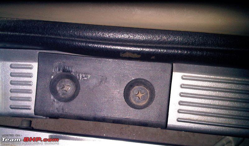

Originally Posted by shams_4x4 View Post
Can you please post a picture of this (where exactly one has to place the pieces of CC) for everybody's benefit.
Shams
Remove these screws and cut the pad in same size as its bottom.
Insert these cut out paddings and tighten the OEM rubber pad on top of them.
dadu is offline   (2) Thanks Reply With Quote

Originally Posted by dadu View Post
Attachment 600004
Attachment 600005
If this does not work, Change the tailgate lock to the Sumo type. Rs 750/- at any TASS. complete peace of mind.
