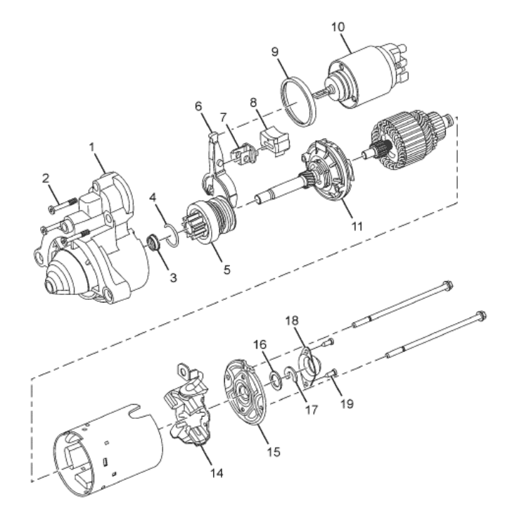

Looks like the starting motor solenoid. If the car is not used much, there is a tendency for the solenoid to get stuck. A good rap on the body of the starter motor with a wooden mallet can help. If it is too much to do for you, you will have to call the TATA breakdown service.
The part No.10 Solenoid Switch may be the culprit. I show the section from the Tata Dicor Service Manual here.
The Tata Safari 2.2L Technical / Problems Thread-safaristarter.gif
Prowler is offline   (1) Thanks Reply With Quote

thats very informative, will ask my brother to do all this tomorrow morning and let you guys know
