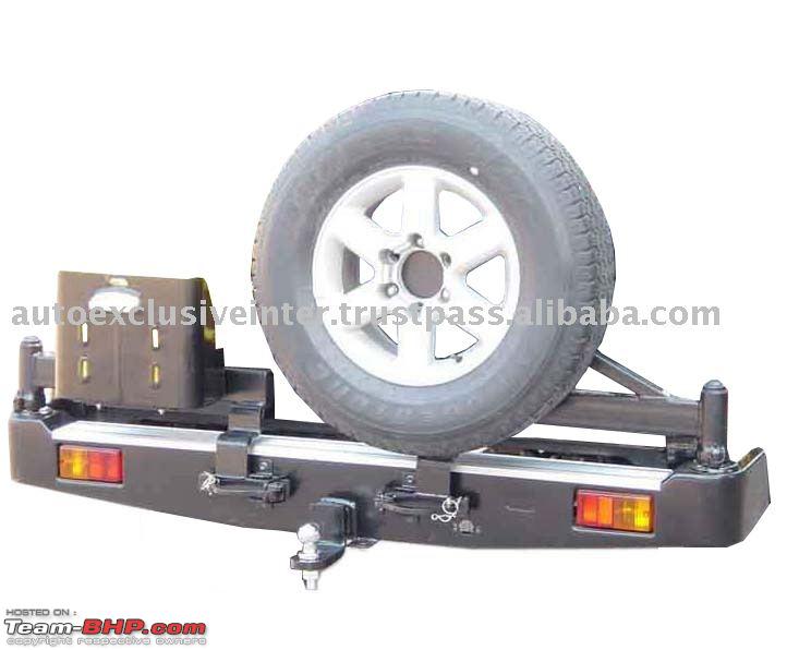

I was thinking more on these lines. Initially for a Safari Storme 4x4 but since the Storme is not so cheap in the 2nd hand market, I thought of just going in for a 2.2 Dicor 4x4 and adding this type of bumpers.
Looking for your opinions on this.
