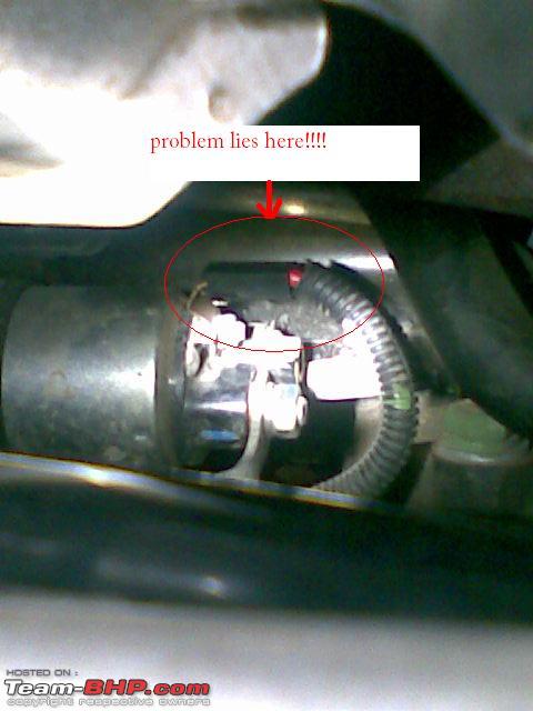

I had this experience with the Starter of my 2.2, Thrice my engine would refuse to start, Checked the battery, and I could hear the "Click Sound" for the starter relay when I turned the key (so that was ok) and also the fuse was ok. Twice I called up the Helpline and after an agonizing wait , it was rectified on the spot by the mechanic, the third time there was a supervisor so when I asked him, he told me that one of the connections to the starter was a plastic quick disconnect and the same was coming loose due to the vibration especially during shut down. the same day I wrote to TATA and surprise..surprise, the next morning I received a call from Pune Factory enquiring the details of the problem and the day after the Rep & Mechanic from the Chennai Area office picked up the 2.2 to the wokshop and did the perm fix (actually the put a snug heat shrink cover on the rogue connector). But I too was surprised at the quick response from TATA very unexpected!!!
Besides now I do get better & quicker response when I drive into Manipal Service
She's done about 11k on the ODO and an April 08 purchase. the first problem happened at about 4.5k.
