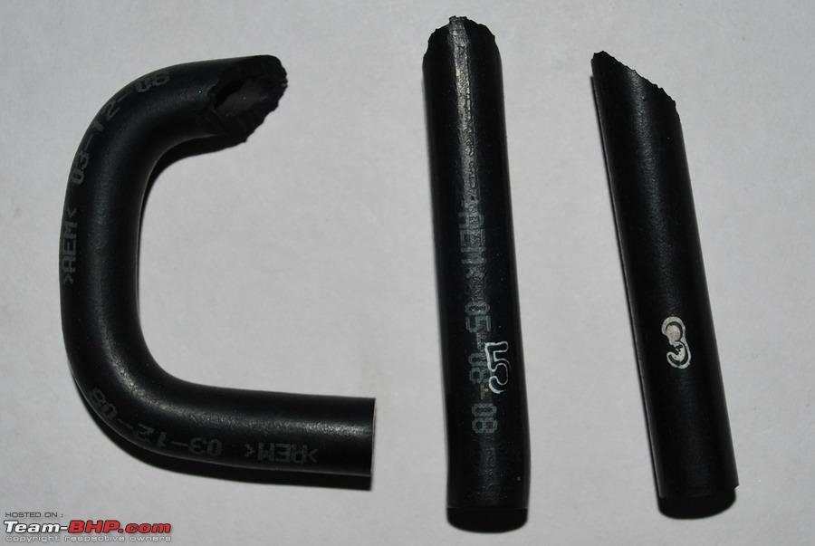

Under Boost Pressure issue resolved! Blame it on Rat!!
It is interesting when you visit your *** with enough data to show them and what I experienced was amazing!
So I go there at the service station in the evening, and the response?
Sir.... leave the car, we will check and get back to you tomorrow.
That didn't happen in my case! So had called up Mr. Patil and reached there in the evening, Mr. Patil was busy (expected, towards closure of business time), a service engineer is assigned, and a curtsy,
SA: "What is the problem you are facing with the car sir?"

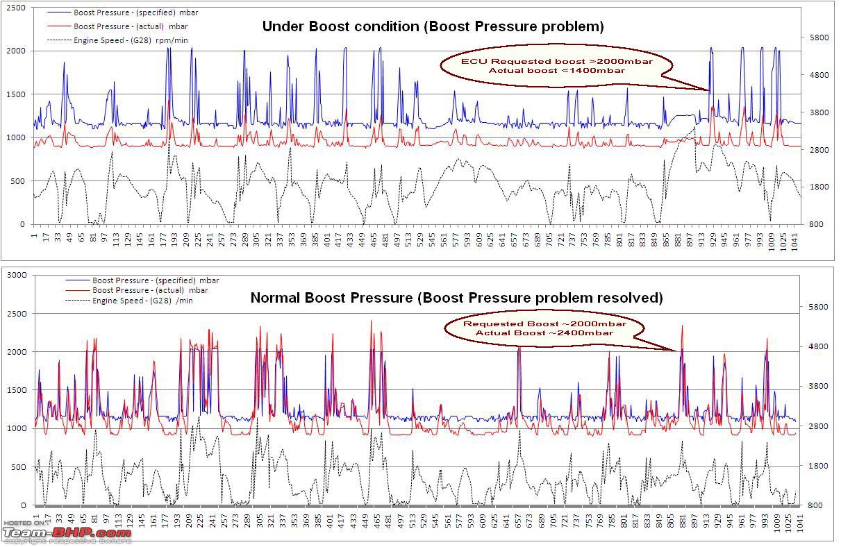

Me: Let me show you..., pulled up my lap top, showed him first the VAG reading (where Boost Pressure Control: Pressure not reached was displayed)
SA: Sir, we will check... it may be because of some dust or some thing, sensor might have logged it...
Me: I don't think so.. Let me show you some thing more! Pulled up the graph that I had handy! rpm, boost specified and actual all plotted from 2 cars, see previous thread)!
Me: This is not a one of problem, I have an issue of Under Boost pressure! Boost pressure never goes beyond 1200 mbar! Seems like a problem??
SA: Yes sir, we will check, but now I cannot say anything more to you sir... you seem to know it very well..
Me: Not really... can you check following?
1. hose pipes connected to EGR is OK.
2. EGR and turbo are OK?
SA: yes sir I will check, we will let you know by tomorrow evening...
Me: What? No way, it doesn't even take 15 min to check the hose pipe connections... If this is not a problem with hose pipes, I'm not going to leave my car here anyway...
SA: Yes sir, we will check...
And then again a VAS (Skoda authorized diagnostic machine) testing is done and everything seem to be OK is the verdict by the mechanic who attended... stupid...

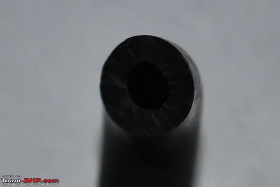

Me: Can you please check around EGR valve please? there must be either a hose pipe that has come out or loose...
And then what he reveals! 3 hose pipes are completely cut by some RAT!!
And the dent? Rs. 859/= on the pocket... but a big relief... It would have been a nightmare if it was turbo/EGR problem...
By this time, had a good chat with Mr. Patil and we went for a test drive, while I logged the Boost pressure again today! and suddenly every thing seemed just alright...
After this, i did feel smoother acceleration compared to before and felt little more powerful like before...
