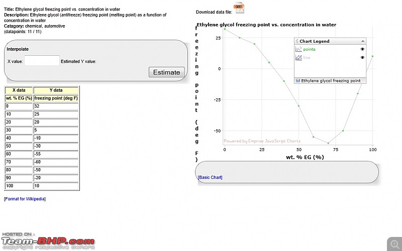

Back to the original topic. Coolant is invariably Ethylene Glycol based with addition of anti-corrosive agents, lubricants, etc. The table has been mentioned by me in Post #75 here and I have now managed to get the chart (unfortunately in F) and the table (XYdatasource - Fundamental Research Data at Your Fingertips) which are shown here. See that the freezing point is NOT the lowest at 100% Glycol but at around 65%. So for the majority of us the issue is protection, and not the anti-freeze properties. (You can also see the data in C as well at Ethylene glycol - Wikipedia, the free encyclopedia )
