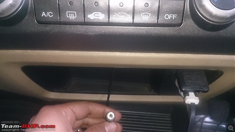

I would have loved to see a description of your setup to get my local guy to replicate it. I guess I missed your post on the topic, might have saved me some time.
I just stumbled across this method when browsing for something else online and since the aux-in port connector wires weren't available locally, ordered it online.
I had the same concern for the eventuality you faced and the accessory guy who fitted it for me said if the cable goes faulty, as long as the aux-in port connector which connects to the back of the HU works, he can make another aux-in wire for me. How did your chap do that crucial connection?
My chap took the HU out and did the connection in such a way that I got a cable out from the back of the HU to the front which ends with an aux - port. Attached pics for your reference. This allows me to just get an aux wire and enjoy my music. When the wire goes bad, I simply get another one. Plain and easy.

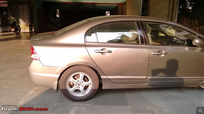

Yes, got the car back in promised time. Sorry couldn't write about it - completely missed. Summary of observations with wagenwerks:

Running Board repair: RHS running board had scraped through a road divider while taking a u-turn. Color matched perfectly and denting job done neatly.
8/10.
He lost 2 points here because I had asked to touch up other scratches as well, but they didn't because "it would have looked bad" (sic)
Also I had asked him to work on the clips of the rear bumper - a job that was completely ignored/missed or note done on the pretext that the bumper itself has gone kaput and replacing clips ain't going to work! - Hard to believe since the bumper seems to be unotouched
