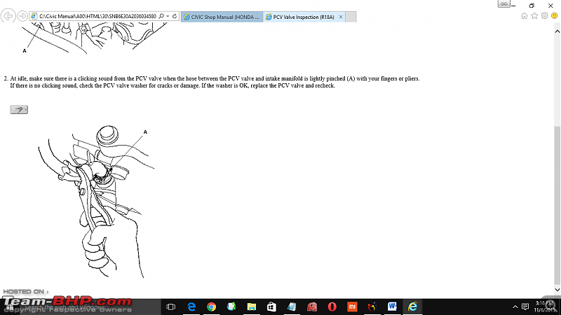

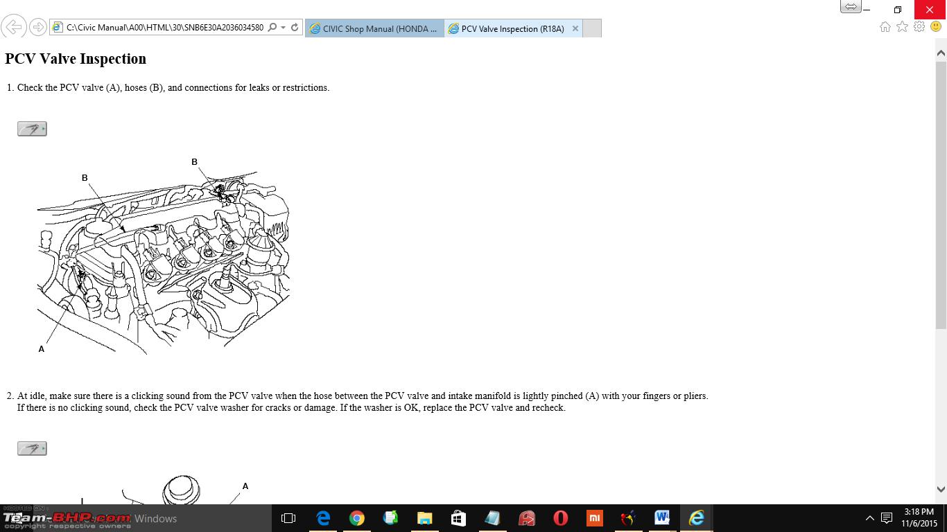

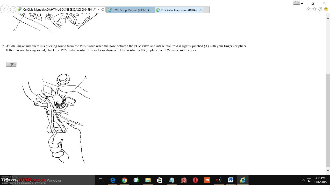

Default Re: Honda Civic : Maintenance, Service Costs and Must dos
Originally Posted by VineetG View Post
Have the same problem, if revved hard. Does not happen above 110/120 if acceleration is not hard/revved agressively. Its an AT. Have searched for a solution in various forums, but no concrete answer.
It started once when i drag raced it.
HASS says everything is fine. Living with it as of now.
Done 95K kms.
Rgds
The smell would creep into the cabin when you hold the revs above 3K for a short time. Many civic owners abroad have narrowed it to the Vtec being in operation at high revs.
The most likely culprit is a non-working PCV valve. Have it checked and replaced, the problem should disappear.
Honda Civic : Maintenance, Service Costs and Must dos-image.png
Honda Civic : Maintenance, Service Costs and Must dos-image-1.png
Pashin is offline   (2) Thanks Reply With Quote
