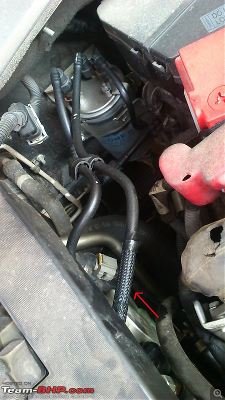

My Vista which is going to complete 3 yrs in a couple of months refused to start for the first time but after repeated cranking she started and the engine malfunction light came up. Upon checking I found out that the fuel pipe from/to the fuel filter is leaking. I have attached a pic of the same. I don't think I can drive the car now. Experts or somebody who has come across such kind of issue pls advice on the action to be taken and the cost incurred.
