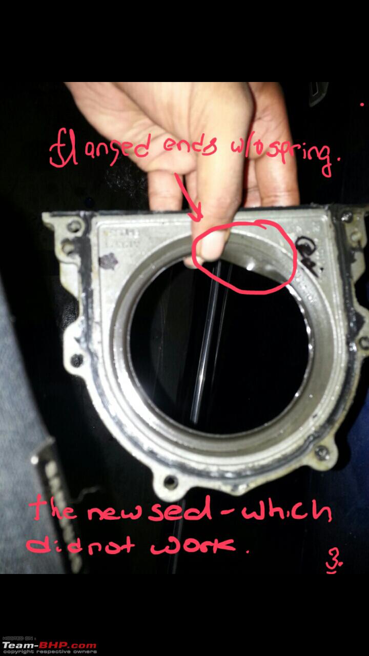

Hi guys..I am unable to find the original main seal (the one behind flywheel) for my w124 e220 1996. Oil was leaking something like a 2-3 drops a day, but nevertheless thought of getting it replaced. Unfortunately the new seal, which I replaced doesn't have the circular spring behind the rubber seal like the original one. It is simply flanged out and thus doesn't provide enough tension, hence oil started leaking straight away post install. I checked shops at palika bhavan delhi and they all say that that this is the new design and the only one avaliable and the old one is obsolete. Is this correct? I checked at many shops they all have the similar type. Can someone help me source the original type aeal? Please?
Please see the pics attached describing my situation.
Thanks!
