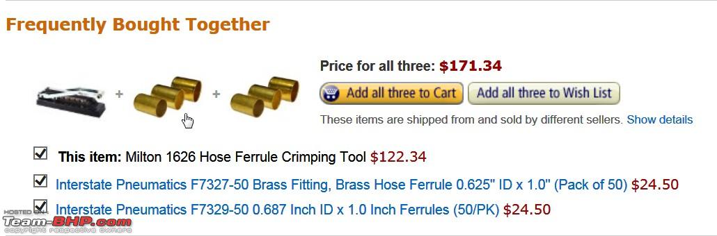

Just what I would have done, except I would have used a coat hanger. Assuming it is the straight end, can't you cut off the crimp, cut the hose to size and have it re crimped? I don't have the tool, but I am sure there is someone who can crimp it for you in Delhi. Attached is a picture of a tool and brass fittings that could do the job.

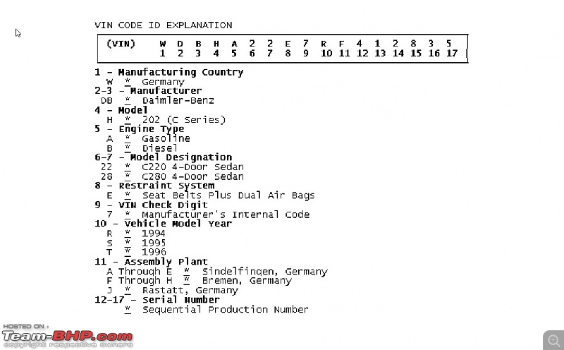

Can anyone tell me where to find the vin number in the chassis on the car? Its not on the plate on the cross member near the radiator.

On the firewall, top left corner near the engine.

Mercedes VIN code identification
