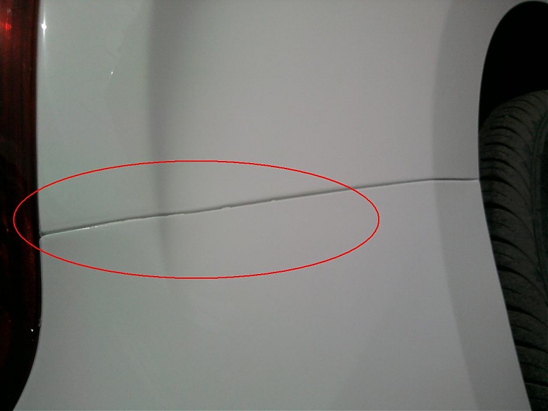

Firstly, I was inspecting the four corners of the car and noticing the panel gaps between the bumper and the body metal on all four sides. On the rear right side, the gap seems more like an aftermarket repaint job than a brand new car. Notice the paint touch-up like effect whether there is usually a clean panel gap (encircled). The other three panel gaps were perfectly even and had no flaws. I'm wondering if this was a repaint, and whether an incident caused the delay in bringing the car to the showroom yesterday.
Panel gap at other three corners.

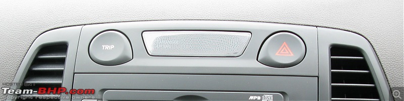

Secondly, and more annoying, this one. The centre console is fitted in such a way that the top has a very irregular panel gap right above the TRIP button. It's clear in the pics I've clicked and attached. Any of you i20 owners (Sawyer, ReckDriver and all you lucky others), I'd like you guys to confirm whether the same panel gaps are present in your babies. And I'm really sorry if I've made you hyper about your cars!

Something about which noone has commented - looking at the encircled portion I certainly feel it has been repainted.

Nice observation. The bumper seems to be oversprayed ...
Attaching a pic of my i20 dashboard...

No comments regarding the dashboard console, but uneven gap at the corners of the bumper is normal i say. When i went to take our i10 i had noticed this in our car and other cars as well.

Actually, i wouldnt be concerned about the gaps in the corners of the bumpers... but the bumper/panel seems to be repainted!!
In portions pointed out below, there appears to be dried paint in between the bumper and panel!!
