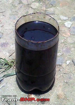

Yes you are right. I remeber he changed oil at the end of service which took quite long and till then engine must have become cold. So today I drained excess oil till the oil reached max level in stick. There was about a litre of excess oil. What shocked me more is the color of oil, its black Just 3 months of running can make it so black? My daily running is only about 10km. Something is definately wrong here.

hashim, most oils will be black after even small amount of usage.
Attachment 169788
I dont think you should judge oil by the colour of it. The fact that it is black could also mean that it is doing a good job at suspending soot in your engine. Sometimes you may find oil is black even after just 100km of driving after oil change.
You should perform a Used Oil Analysis to determine how much life is left in your oil.

As already mentioned, colour is not a reliable indicator of any problem. On the other hand its not impossible that you have a problem. There could be a leak somewhere that is contaminating the oil. Oil analysis is the only way you can be sure.
Meanwhile, keep a v close watch on the oil level.
