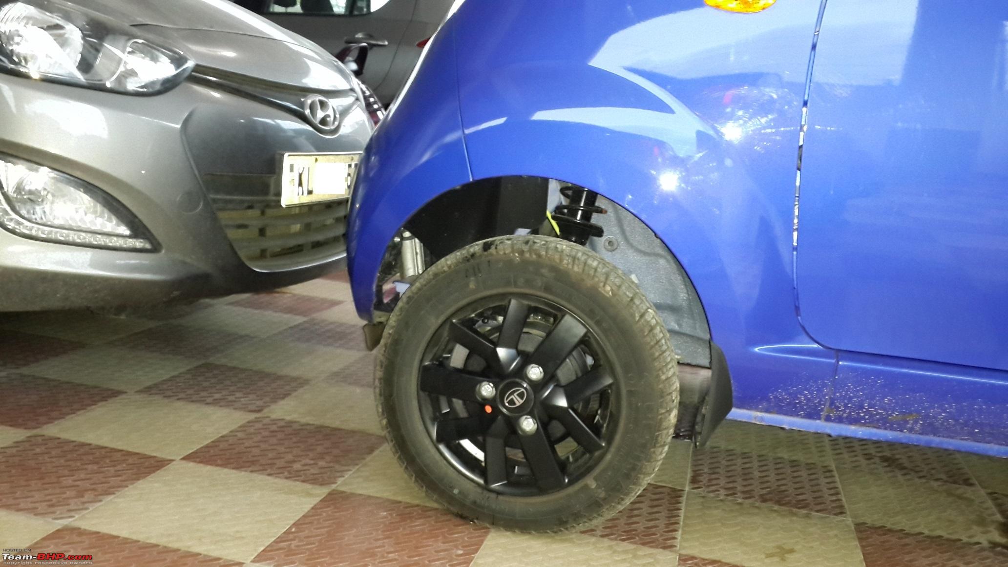

Crappy JK tyres. Alloys an approved accessory from dealer. Meeting up with her elder brother in front!

BTW, nice alloys. I have the same but in silver. The black looks good.
