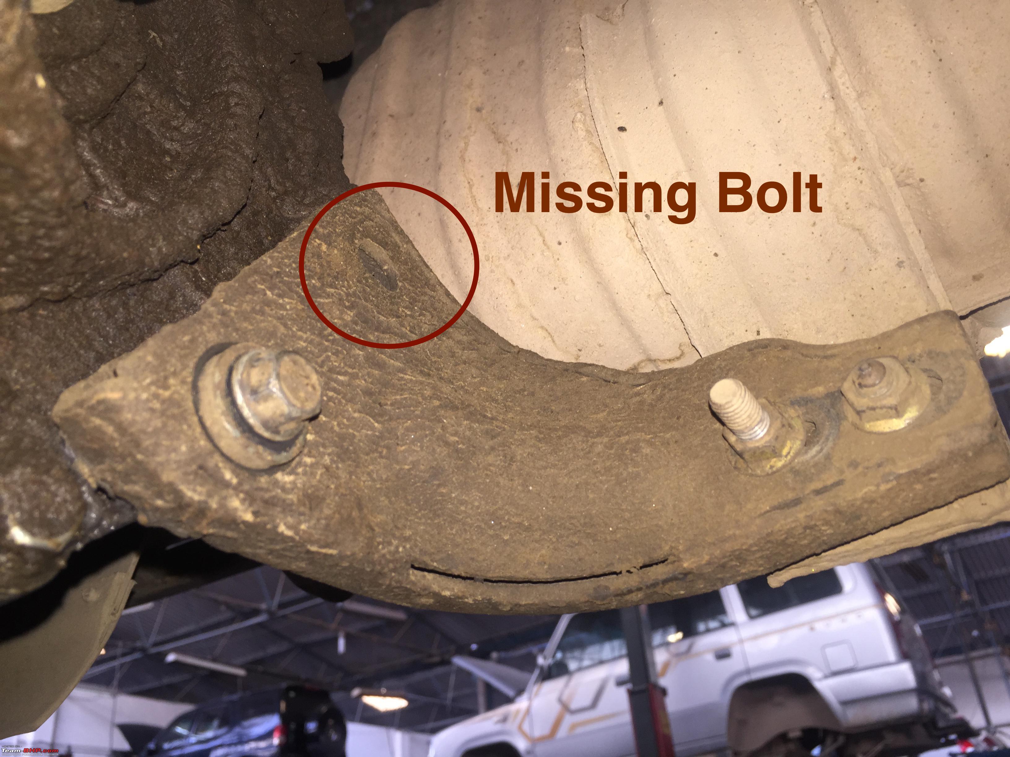

Originally Posted by Tanmay K View Post
Hi guys
There is a repetitive problem that keeps cropping up again and again in my 2014 Nano. The bolts that connect the silencer to the gearbox housing keep coming off. I have gone to the TASS to get it fixed thrice already and each time they have installed new bolts (for Rs 300).
Yesterday after my 30k service one of these bolts came off again (and the other one became loose) and I went to Dhingra motors in Gurgaon to get it looked at. Unfortunately the SA who usually oversees my car was on a weekly off so the issue could not be resolved as I would go there another time.
In the meantime, anyone has a clue why these bolts keep coming off? Is there a way to permanently fix these bolts in their place?
As a result of the loose bolts, the silencer of the car becomes very noisy.
Here is a photo I took today. Notice the missing bolt and the loose bolt below it.
Attachment 1413180
You get a solution named Loctite which you put on the threads. This is supposed to "stick" the fasteners after it dries out.
Please note this is not a permanent joint like welding. The bolt can still be unscrewed if needed by applying some extra torque.
Loctite is used extensively in bicycles where the bolts are too small to apply excess torque for tightening, at the same time you don't want them to come loose during normal operations.
Silender may be vibrating too much which in turn is causing the bolt to get losse or sheer-off.
Did you check with TASS if there is any fire resistant packing material which is missing from your car? I am not sure.. but its good to ask.
