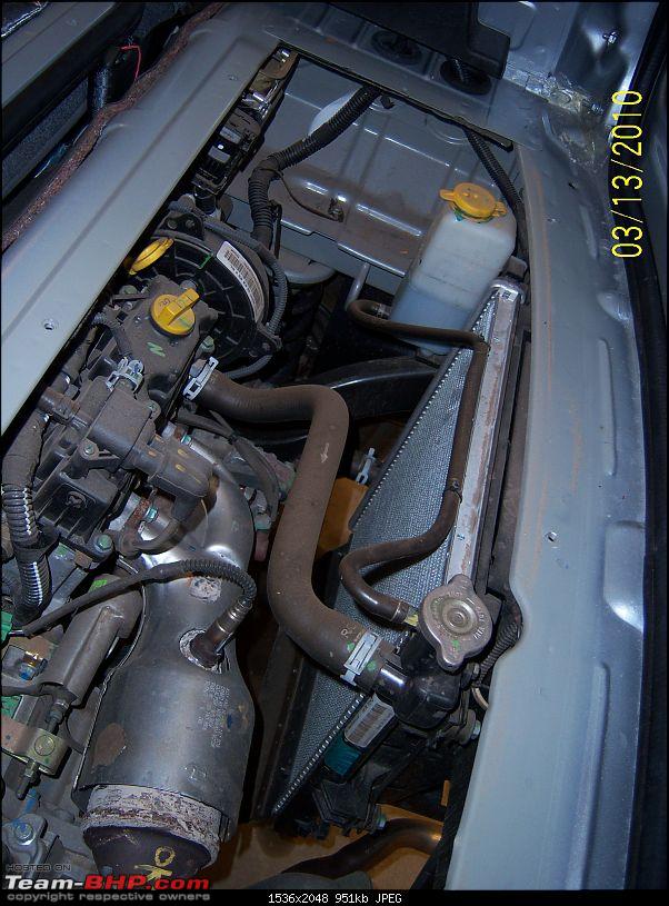

Originally Posted by akshay4587 View Post
It has an Air cooled engine,doest it perform normally with AC,when temperature's go as high as 45 degress?
Thats a water cooled engine boss.
Had it been an aircooled engine, it might have been even cheaper. But I still wonder why it was not air-cooled. It is more or less like 2 RE bullet engine (in terms of engine capacity) on the same shaft.
-Ilango
No, it does not. nano has a water cooled engine. Pic attached. You can see the radiator and coolant overflow tank.
More pics here.
Link
To answer your question - The engine is perfectly OK in Chennai conditions. I was there on 4th and 5th of this month, Chennai was around 39-40'C and the AC cooled quickly and stayed like that, and engine did not overheat.
Nano has a liquid cooled engine as seen in the pictures.
