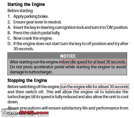

Default
Originally Posted by Steeroid View Post
Safari Dicors manual doesnt suggest this kind of idling
Wrong. My Safari DiCOR 2.2 manual (Feb 2009) has this notice extremely clear. For the record here is the excerpt from page# 76 of the manual (PDF).
I have been following this to the core and has become a second habit when I am in Safari. Waiting to shutdown, initially, was bit embarrassing, especially with sites having valet parking. But, now I am used to this and insist parking myself.
