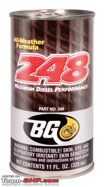

Update: Spoke to someone from BG's India office. He is unable to provide BG Diesel Thaw, but suggests instead that we use a product called BG 248 instead. Check this out...
from BG Company.
I'm expecting a price quote for bulk purchase on the email in a day or so. In the meanwhile, do you think this will serve our purposes, and work to prevent diesel gelling in sub-zero temperatures?

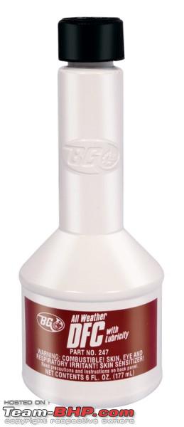

The CTO, BG India, has kindly forwarded the brochures (*.pdf files) for BG 247 and BG 248 for my reference. I am yet to get a price quote from him, but here are the brochures. The gentleman himself has been to Ladakh multiple times, in vehicles ranging from Innovas to Taveras to Sumos, and he reports having used BG 247 in all these vehicles - and never faced cold start issues. Sounds like we may be on the right track about solving the collective problem of diesel cold starts.
0247.pdf
0248.pdf
Will update once a firm price quote comes through.

Finally received BG247 bottle @Rs.450 each (6 fl.oz., 177 ml, says it's good to treat 40-150 litres of diesel.
