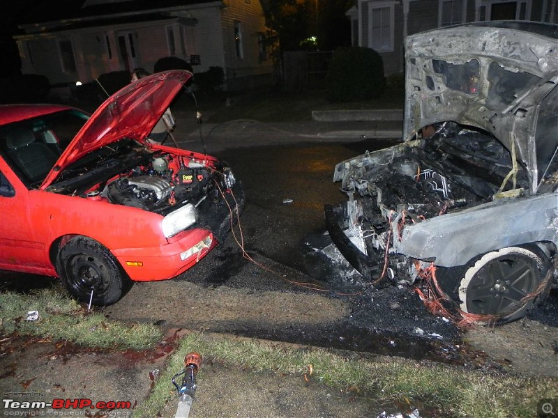

You should be very careful when you jump start cars. Here is a picture of jump start gone very wrong:
http://i.imgur.com/srd4T.jpg
source: A friend of mine was helping a girl jump her car...she crossed the wires : pics

Above pic looks horrible, & makes me think whether or not to continue with below post. But, when the battery is dead, PROPER jump starting is the way in most situations.
Pretty interesting photo... and I was skeptical at first as to whether it could actually happen. I still doubt whether simply crossing terminals could do this.
BUT then I remembered one time when I was at a used car dealer in rural Thailand and the guy wanted to jump-start a diesel Nissan pickup that was for sale. Carefully taking into consideration the potential danger of connecting the negative (earth) lead to the battery terminal of the dead vehicle, this brilliant fellow searched for an alternate earthing point, finally deciding on ONE OF THE METAL DIESEL FUEL INJECTION LINES - to which he clamped the lead, thereafter immediately directing his assistant to try and start the car!!! A few milliseconds later, there was high-pressure diesel fuel spurting out from where the current had arched and burned a hole in the line. Very fortunately, no fire - but if it had been a petrol car (petrol is much more volatile / combustible), that probably would've been the end of at least one vehicle (as in the photo) and maybe of the three of us, too. God's grace. But in conclusion, maybe it should just be said that, "stupid people shouldn't jump-start cars". C'mon - A FUEL LINE!!!???
-Erik
