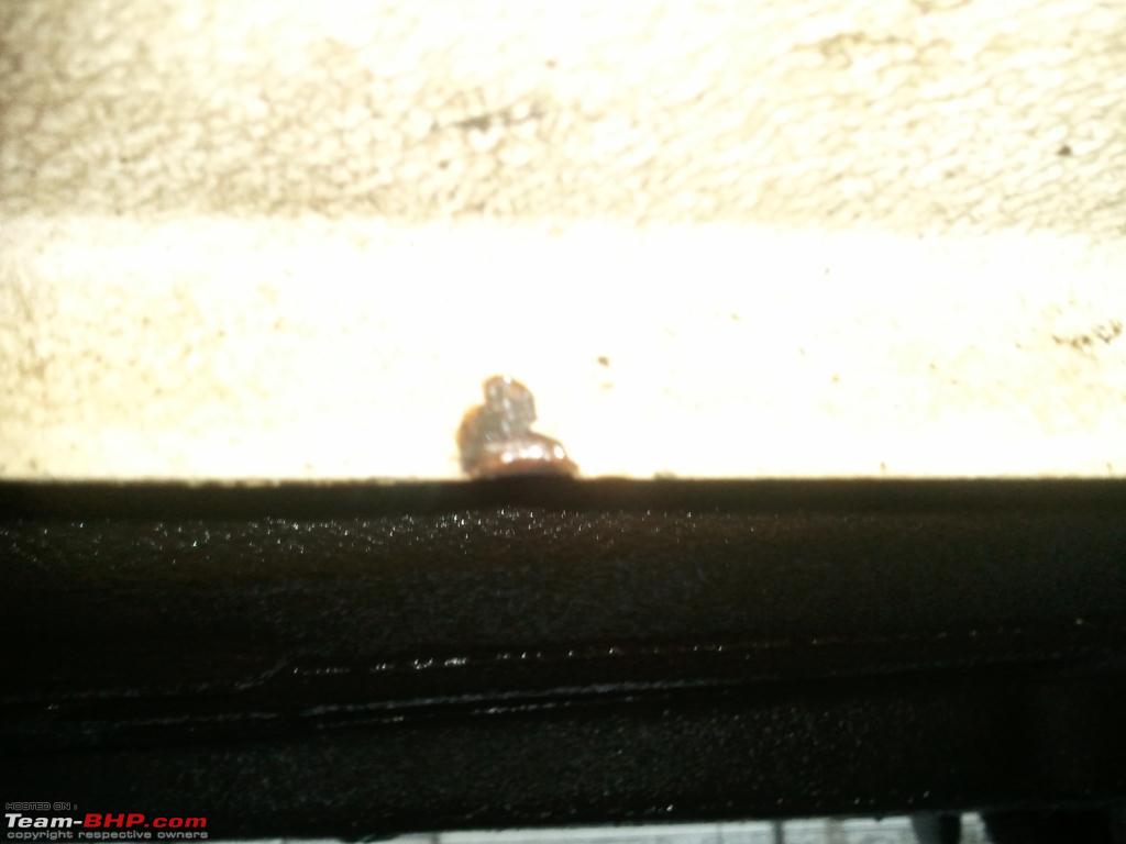

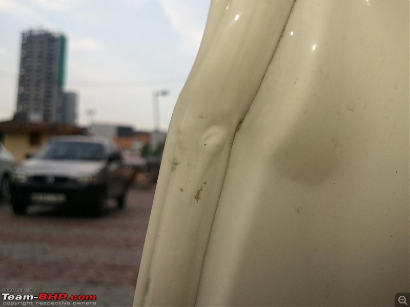

Hi Guys,
This thread is with regards to the specific paint issues that i am facing with my car, i.e. Ford FIGO.
Kindly give a look at the issues that are pertaining with the quality standards of FORD India and let me know the resolution that i should take for the same.
please note that the pics have been taken from all sides of the car and rarely in my car you would find which is not affected by this issue.
Pics taken by samsung wave in macro mode.
also check post no 2 for more pics of the same issue.

Ford Figo: Factory Paint giving Nightmares !-photo0039.jpg

@Dinesh - That's a poorly done paint job for sure, sorry to say, this is how my 6 year old WagonR looks at few places. The dealer or the manufacturer might not agree for the paint that has been chipped, for example photo0045.jpg & photo0106.jpg because they might feel, you might've had a slight knock somewhere; you may want to show some inferior paint jobs with interiors.
On the other hand on the first pic photo0039.jpg, I notice some kind of crack, could you post some more pics on that pls?
might have missed that one while clicking pics :P

I would do a paint chip repair and carry out a full body detail.
If possible, get a underbody anti-rust spray(available with Wurth and 3M).
Sand down the rust and spray it on the underbody areas.
The 'bubble' formation is a real pain. Its called 'solvent pop'.
Only solution to that is repaint.
Has the rear hatch been repainted??
the paint flow is generally seen in repainted panels!!
And the pitting seen in the last pic of 1st post is the aftermath of 'solvent pop'(has it been repainted?)
I guess the car(most panels) were repainted at dealership level maybe due to some mishap.(and it was a shoddy coverup job rather than a full repaint!)
The paint marks on the interiors show that the car has seen paintbooth! Painter might have touched the dash while he was painting the car.
You can check whether any dent correction was carried out or not by looking on the inside of the panels!!
(like if you remove the fender and see that its been beaten from the inside = repairs carried out at dealership level before purchase!)
Most others are rock chips and reminders of some seriously crappy roads the car has seen!

Agreed the paint job isn't the best compared to cars in the segment. There has been a lot of cost cutting.
But I wouldn't go that far as to blame fords painting just yet.
and
seems to have been caused by dirty shoes/feet and mud while getting in and out of the car.
But in some pictures it your concerns look genuine. I'm not defending ford but I feel that you might have got a dealer repaired/repainted car.
Could you explain whats wrong with the AC vents?
