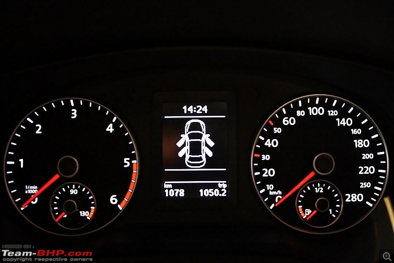

I have noticed this from quite a time now in almost every car but never thought much about it. Almost every car has red line at 30 km and 50 km mark. Is this due to marking some ideal speed to gain most mileage or is it just pure asthetics? Has to be some meaning to it. Can anyone shed some light over this?

My cars do not have these marks on their speedometers.
I am only guessing here (and could be way off the mark) but I think it may have something to do with mileage or gear changes @ a particular road-speed and RPM. You would find the best guidance in your owners manual.
PS - Since this thread is about shifting gears, I generally shift gears between 2000 and 3000 RPM depending on where I am driving and traffic conditions.

Thanks for your input on this. Did a little research on my end. Some says it's to remind you of city speed limits in some countries other says its ideal gear shift speed for 1st and 2nd gear. Not very sure about this. I think my car will touch 30 kmph in first gear in around 1800-2000 rpm. Will have to see for sure when I go for a drive next time.

Did some Google search and got to know that they are speed limit marking.
These marks are speed limit reminders. Depending on the car it may have marks at one or all of 30, 50 and 130 km/h. 30 km/h is a common speed limit in residential areas in Europe, 50 km/h is a common 'default' speed limit in cities and towns around the world.
EDIT: Just saw you posted the same.
Speed limit theory makes sense IMO.

Yes! Just drove the car and the RPM reached all the way to 3000+ in first gear in order to reach 30 kmph mark. So I don't think that its marked for ideal gear shifting speed. This might me more like upper speed limit which you shouldn't cross while driving and should change gear under this mark. But then again I would just be guessing.
