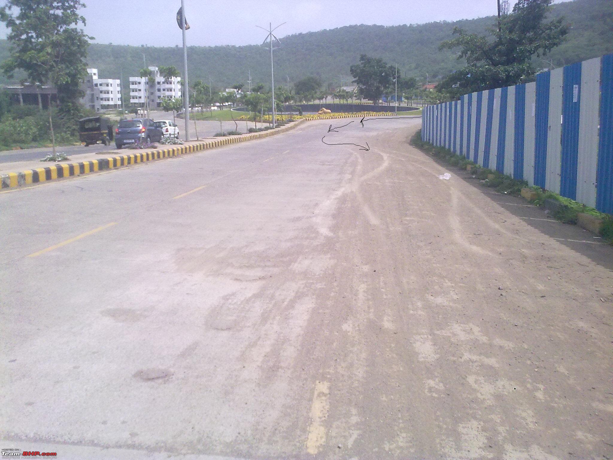

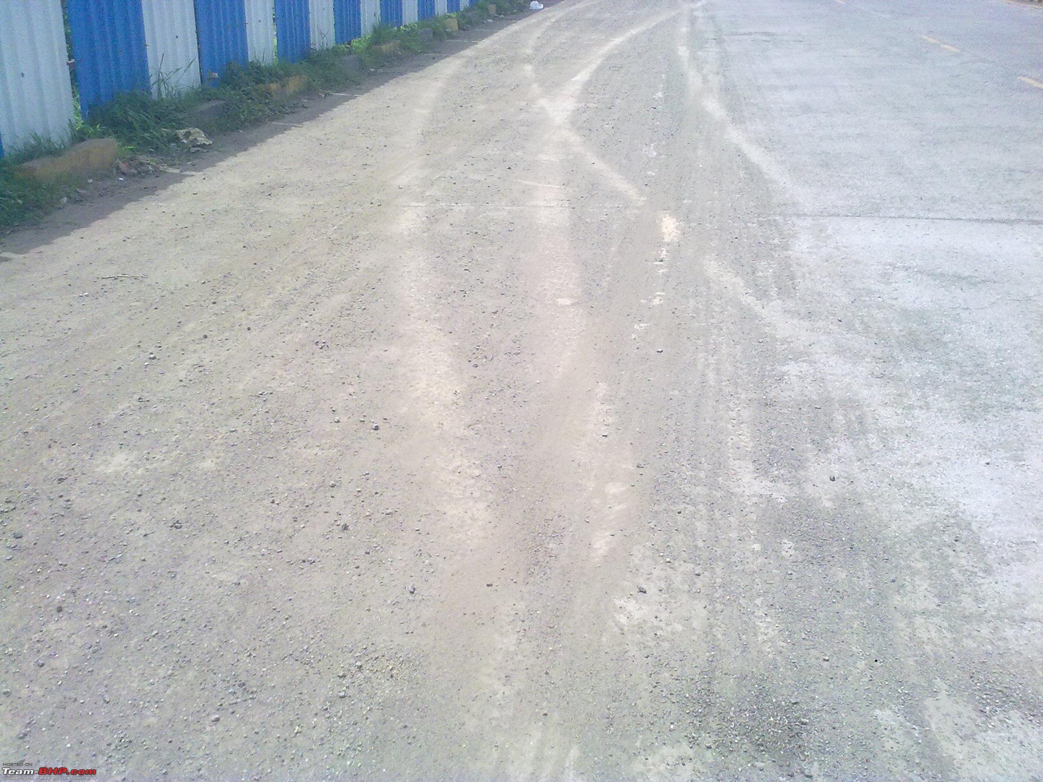

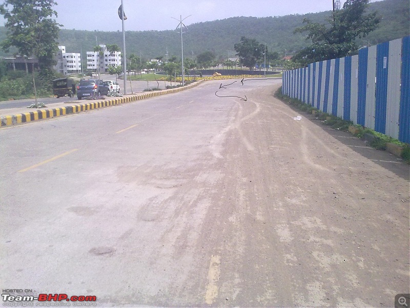

Originally Posted by anilisanil View Post
I had a heart in mouth situation. Seriously, I just got saved from what seemed to be a 99% probable crash and that 1% acted for me.
I like pushing my car into the corners and when I find empty roads with corners, I push it. Today when I was doing this corner (I take this route daily), I thought my speed was a bit high for the corner, I intended to downshift and brake. The CAR JUST DIED ON ME when I pressed the clutch!!
The car went on spinning for three times while I literally stood on the brakes. There was no control whatsoever on the steering. Luckily for me there was no motorist and the lonely pedestrian saved himself by standing on the kerb, hugging the sheet metal walls of an under-construction building.
I am literally shivering as I type this.
As I understand the dynamics, I would have had the control of car if it were not to shut down. I agree I was partly at fault, but it was my daily route and was confident, but even then I expect my car to be running in such emergency conditions. Please note the road was completely dry and there is no good reason why I should lose traction. My tires too are pretty much OK.
Jayded: How is your car doing?
A few pics of the incident.
Figo TDCi: Dies occasionally while downshifting! Solved: Updated firmware by Ford-05072011030.jpg
The left and right wheel tracks intersected.
Figo TDCi: Dies occasionally while downshifting! Solved: Updated firmware by Ford-05072011031.jpg
The point from where I lost control.
Figo TDCi: Dies occasionally while downshifting! Solved: Updated firmware by Ford-05072011032.jpg
The path just before the curve where I stopped, so I couldn't possibly doing more than 50-60 Kmph. I wasn't indeed.
Figo TDCi: Dies occasionally while downshifting! Solved: Updated firmware by Ford-05072011033.jpg
A closer look at the skid marks
Edit: The car stalled again when I was returning to work place (This happened bang opposite to my workplace.) after taking these pics.
