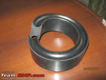

Ok, my courier arrived today - two 1" donuts for the rear. Will get it installed possibly over the weekend. Someone asked about weight, its weighs around 700-800gms each. Size - roughly 6" dia and around 1.6" high on the outside (if you measure the inside, it should be around 1"). Rubber looks to be of good quality. Some pictures attached. Will update further once the installation is done

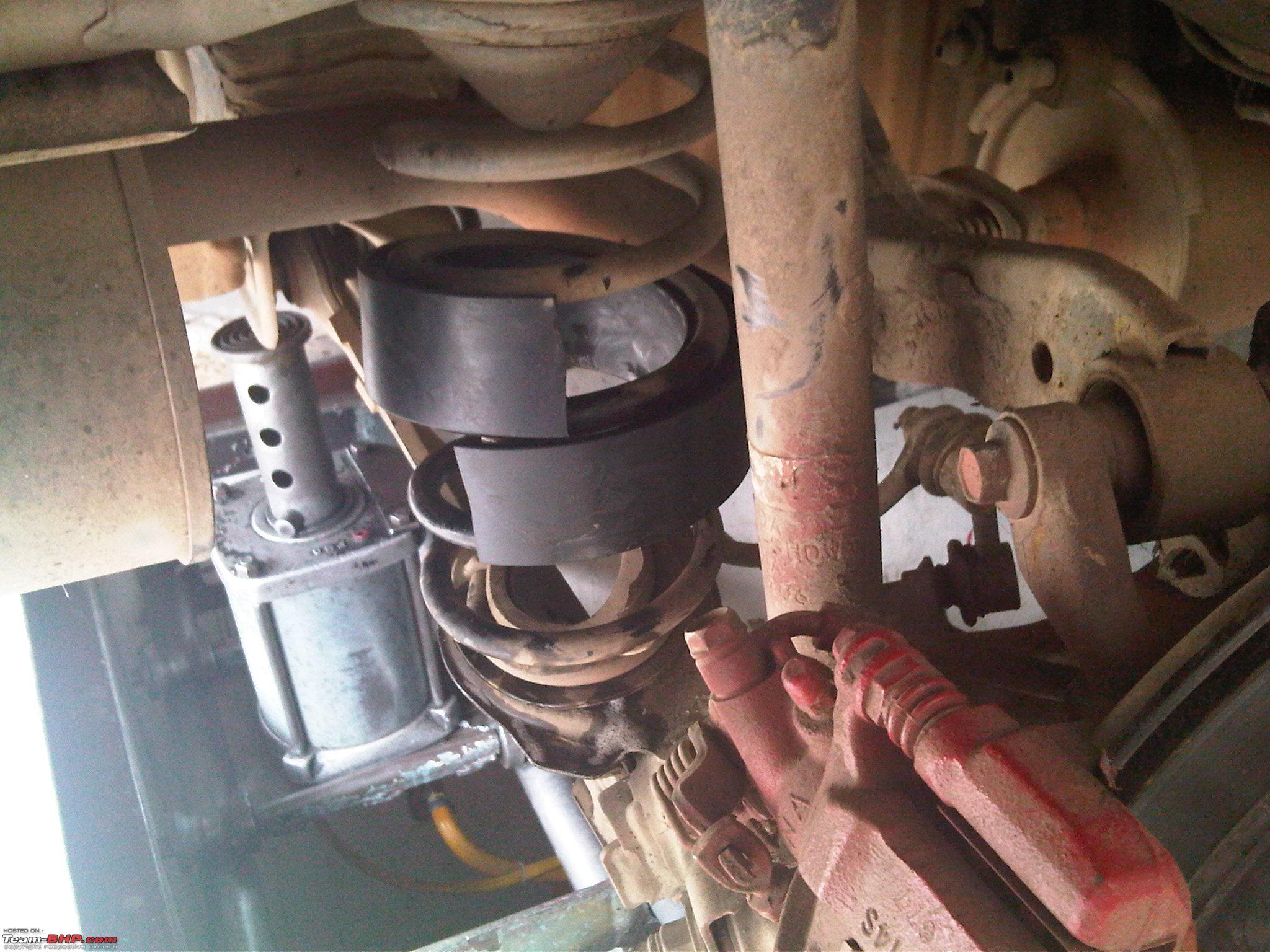

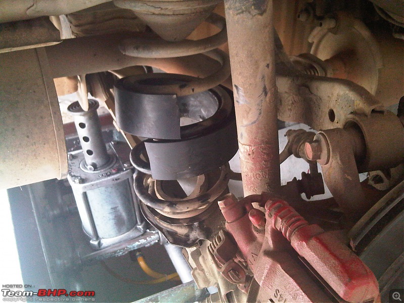

Got mine installed today at the rear. Was a 15 min job followed up with alignment. Alignment showed no variation from stock. Did not drive much for a full experience, just back home from the garage with only me in the car. The rear feels a lot more planted, and from first looks, the car has a more tipped forward and purposeful stance. The bounciness of the rear has reduced and I'm urged to take on speedbreakers without worry. Tried over couple of humps and there was no scraping or bottoming. Need to try with a full load and over some notorious speedbreakers in the coming days. Will keep you updated. Attaching some snaps of the installation.
