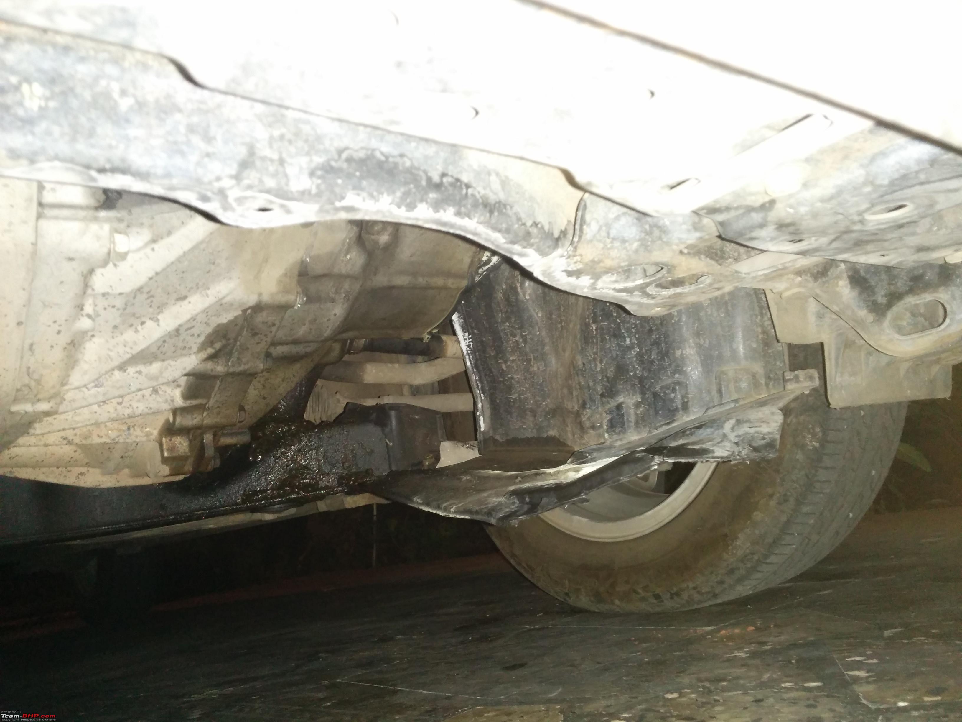

Guys need your help to assess what has gone wrong here. A relative did a 500 km drive last Sunday and whenever he went above 80,he heard a grinding noise like some plastic parts are being rubbed against each other. Pulled over 3 times but was unable to identify the cause.
They got home really late so couldn't check it on Sunday. When I checked the underbody on Monday, I didn't like what I saw. Attaching a few pics here:
Notice the plastic flap that has come off. I suspect this caused the grinding noise
Review: 2nd-gen Maruti Swift (2011 - 2017)-img_20150318_223657.jpg
Underbody seems to be drenched in Oil ?
Review: 2nd-gen Maruti Swift (2011 - 2017)-img_20150318_223800.jpg

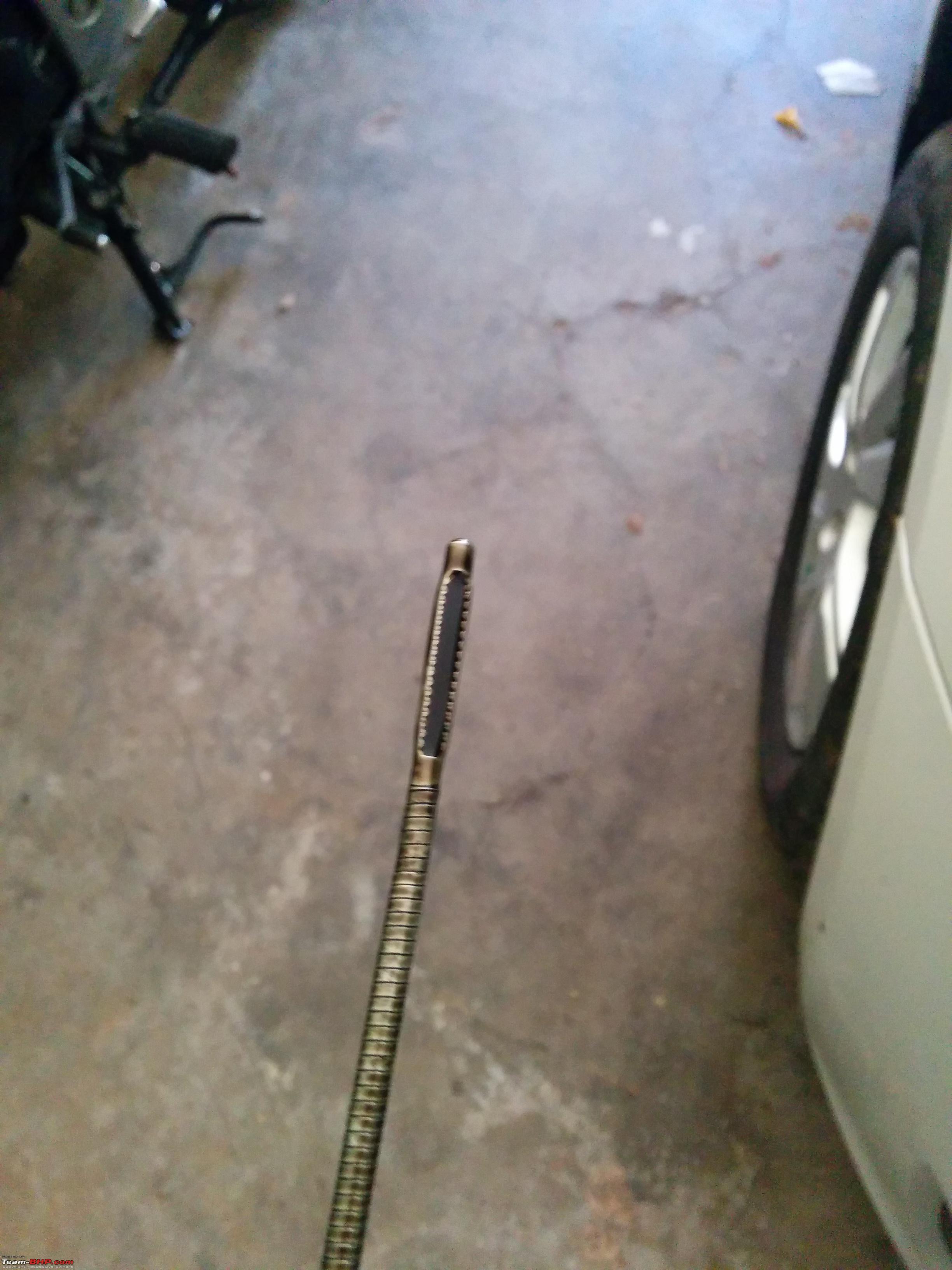

Oil level too close to Minimum level ?
Review: 2nd-gen Maruti Swift (2011 - 2017)-img_20150319_191225.jpg
Review: 2nd-gen Maruti Swift (2011 - 2017)-img_20150319_191833.jpg
Review: 2nd-gen Maruti Swift (2011 - 2017)-img_20150319_191858.jpg
Isn't the oil level dangerously close to 'Min' level? Sueggesting a engine oil leakage perhaps ?
I don't remember the underbody ever suffering such a hit recently. My Mom said even during the Sunday journey there was no underbody hit. So if its oil,how did the leak happen ? Also,the Temp gauge was at the normal position when they returned.
I haven't driven the car since Monday and plan to take it to the service centre soon. What should I get inspected ?
The engine guard (Plastic) seems to have sheared off. Looks like a underbody hit.
Check the lower arm once too.
Is there any dent or scratches around the area where oil is leaking?
Hope the level was checked when engine was cold!
For now 'Top-up' and change it after you get the source of the leakage.

The engine guard (Plastic) seems to have sheared off. Looks like a underbody hit. Check the lower arm once too.
Those plastic bolts that hold it are missing too. Will get it inspected soon.
I think I'll have to get it on a ramp to be sure. Can't see any for now.
Almost cold. Which is why I think I got false readings. It had idled for a minute,but I let the engine cool down for an hour before checking
Just checked the Oil level now and it seems fine. Here's a pic
Review: 2nd-gen Maruti Swift (2011 - 2017)-img_20150320_142541.jpg
But surely,there's leakage somewhere. If not the underbody won't get drenched like that would it ?
Attachment 1351267
The green colored stuff that you see is most probably the grease from the drive shaft's boot. Look closely and you will find it to be grease.
Get the boot checked for any tear/split/cracks and replace it as soon as possible after cleaning and greasing the cv joint.
That plastic under-body guard is held by flimsy plastic clips and is known to fall off easily. Use a nut-bolt with large washers in-between to prevent this from coming loose .

Dropped the car for driveshaft replacement. 'Intercooled' was spot on with the drive shaft boot having gone bust. It looked like the work of a rat.
