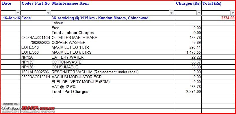

The SA checked in their DMS system and informed me that my car is from the batch wherein two parts have to be replaced (recall).
  • Vacuum Modulator and
  • Fuel Delivery Module (FDM)
For FDM replacement, he said that they will have to open the fuel tank, which will take time. Hence committed delivery time is 05:30pm. I was not expecting this long a time for the very first service, which involved just changing the engine oil and oil filter. However since there was a recall for the two parts and my car was from the affected batch, I agreed for the replacement
He gave the consumables' estimate as below:
  • Engine oil
  • Oil filter
  • Drain plug washer
  • + Taxes
  • Totalling Rs2200/- approx.

The guy also gave me a print out of the RO (Repair Order), which is an internal Mahindra document. It has the details of Demanded Repairs, Labor/Part Details, Maintenance Schedule/Checklist etc. He mentioned that he will call me when the FDM is being replaced so that I can see it by myself. If I cannot come he will take the pictures and share with me.
Below is the copy of Repair Order:
Orange Tank to conquer the road - Mahindra TUV3OO owner's perspective-repair-order.jpg
Second page of the Repair Order:
Orange Tank to conquer the road - Mahindra TUV3OO owner's perspective-img_20160116_212700.jpg

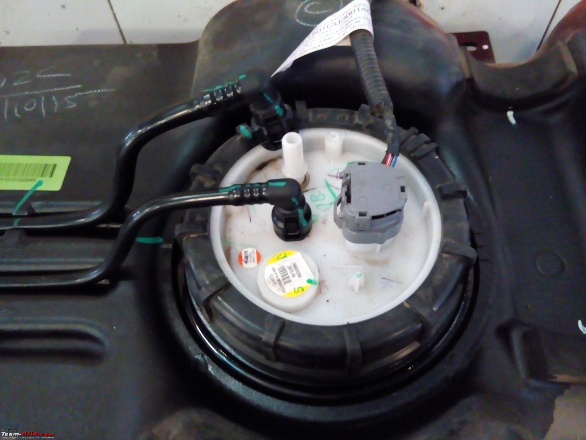

The plastic fuel tank dismantled and kept aside. The central white plastic part is the FDM
Orange Tank to conquer the road - Mahindra TUV3OO owner's perspective-img_20160116_161805.jpg
A closer look at the FDM
Orange Tank to conquer the road - Mahindra TUV3OO owner's perspective-img_20160116_161830.jpg

The whole assembly looks like this. Only the cap remains above the tank (90% sits inside the fuel tank)
Orange Tank to conquer the road - Mahindra TUV3OO owner's perspective-img_20160116_174402.jpg
The technician fitting the FDM inside the fuel tank
Orange Tank to conquer the road - Mahindra TUV3OO owner's perspective-img_20160116_175456.jpg
One good thing about this replacement was that they didn't have to empty out the diesel from the tank. The tank was removed along with diesel, FDM assembly replaced and tank fitted back in position.
Since the other tasks were completed on my car the SA assigned another technician to test drive the car along with me. The rattling noise was reduced to a large extent, however when the car was on higher gear at low rpm, then there was a feeble rattling still coming from right side, left side there was none. The test driver also acknowledged the fact. When we returned back to the MASS, my SA informed me that the beading surrounding the glass will have to be replaced. However since it was out of stock he informed me that he will let me know once it is in stock (which is expected in the next 2-3 The car was washed and handed over to me by 07:30pm. Below is the list of parts replaced and the invoice.
The part and labor cost break-up
Orange Tank to conquer the road - Mahindra TUV3OO owner's perspective-3k-service-details.jpg
