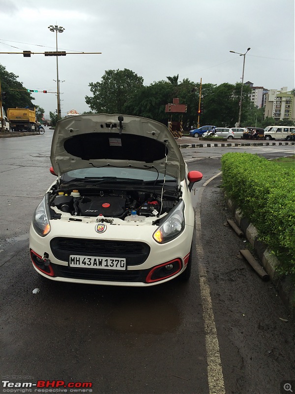

Default UPDATE : First breakdown
Special thanks to Bhpian Noel for his invaluable help
First breakdown of the car. As usual I left for office with healthy amount of petrol in car (20 L approx). As I was moving along Palm beach road, at one signal after restarting ( switched off the car at signal ) got low fuel warning. I opened window and could smell petrol. Immediately switched off the car and asked traffic behind to move ahead. Called up BHPIAN Noel and he came ASAP. Like literally in 5 mins. Confirmed petrol smell in engine bay and helped me push car to the side. A biker helped too, but before I could say thanks he ran off as signal was turning green.
Noel had to go so he promised me to be back, meanwhile I dialled up Fiat RSA. No one was picking up. So called up their sales and was promptly transferred to RSA. The lady was calm, asked for car details and did a conference call with towing car. He promised to come in 20-30 mins.
Meanwhile Noel was back. I got the tow hook in place to avoid time waste later. Towing guy came by promptly as promised. Hooked up the car. Asked me to sit with him and his dad was piloting the Abarth. Took to FASS in Koperkhairane. SA there was prompt to attend to me. The towing guy didn't ask for any payment and left after exchanging numbers. He was praising the Fiat RSA compared to those of TATA and VW on matters on timely payments as well as actual rate of towing.
The issue was diagnosed as main fuel line chewed by rats. Thankfully the engine did not catch fire. Would need to order the fuel line as its one piece and will take some major disassembling to install Will need to keep car in workshop for 4-5 days. Cost estimate is 4k + labour which i expect to be very high.
attached the tow hook
never expected a breakdown
attaching the tow bar
view from the tow van. Depressing sight
You can see the double walled fuel line brutally chewed. Also spotted is wire chewed by rats earlier.
