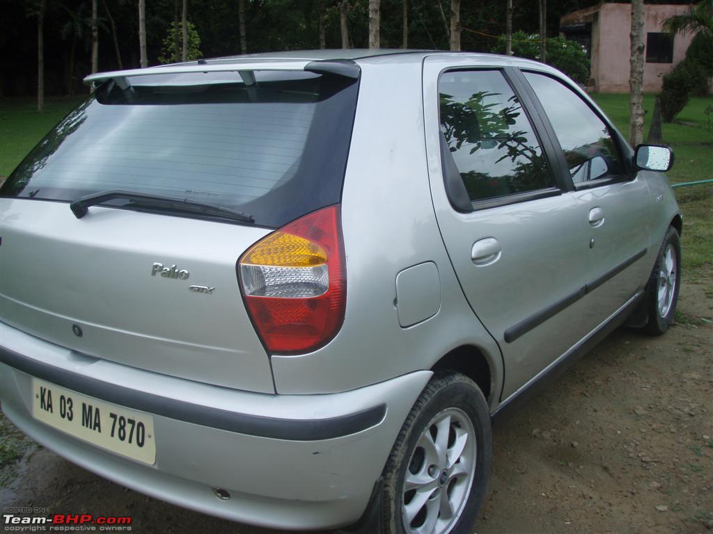

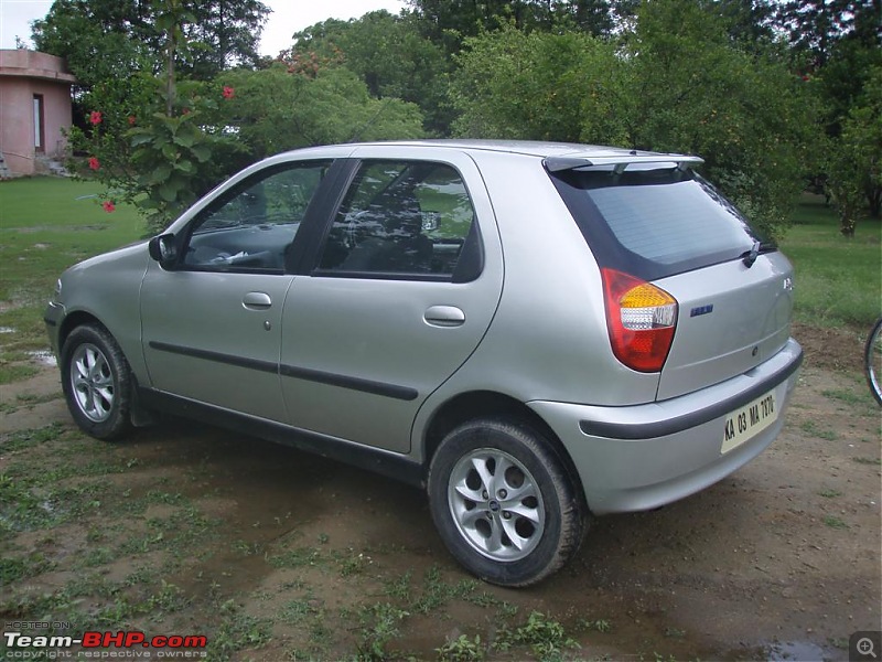

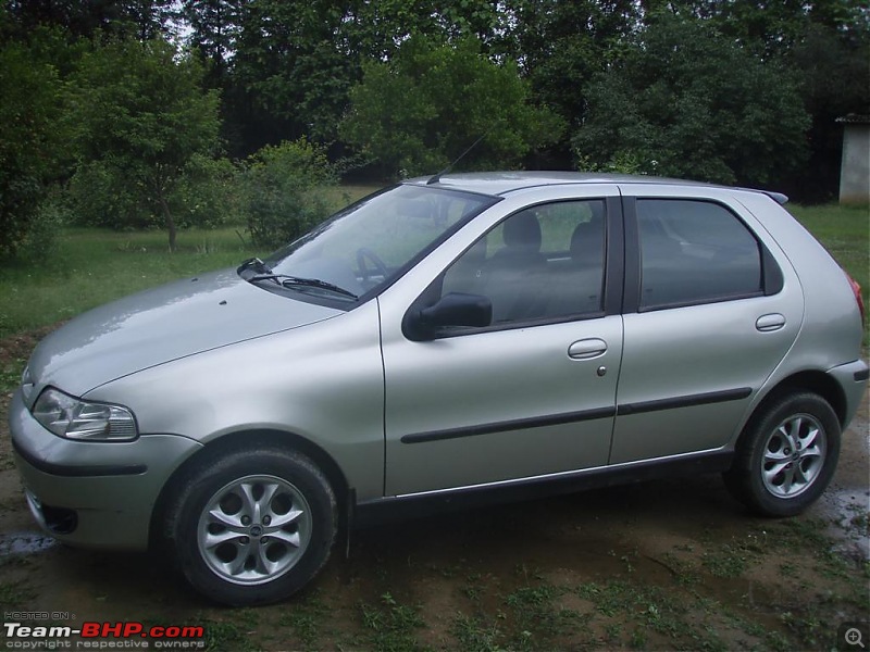

Pics of the Palio are attached.

Default Great to see the car
Hello
I saw your car.Its great.You have spent good money on maintanence.But i would suggest you to get new FIAT logo for the grill and new headlamps.Get the fog lamp scoops and mirrors body coloured as in the GTX.

Nice car and a good review! With all upgrades / replacements done, the total cost would come to around 2.5L? Bet all that money is well spent!
Congratulations!

That's a very clean looking car, enjoy the ride, I was getting a Palio GTX 1.6 2002 with 42k on the odo for 1.3, but just din't have the guts to pick it up, sometimes I wonder, how life would have been with a GTX, if I would have bought the same.

Really thorough job you have done there. Great!
Cosmetically, there are a few more things to be done (apart from what has been said already):
1. FIAT badge in the front.
2. "1.6" badge at the rear
3. 100 16V badge on the left fender. Samyak should have all the badges in stock, from my experience.
3. Get rid of the mudflaps. They look OK on the 1.2s, but the GTX looks better without them. If you want, I can share my GTX's picture for reference.
4. The cover for the tow-away tether is missing from the rear bumper. Ask the Samyak body shop people to get on for you from a damaged bumper, so that you do not have to buy a new one just for that.
Rear seat belts are hard to get. I have been pushing Vivek and Samyak for the past 2 months. Do post pics of the interior.
