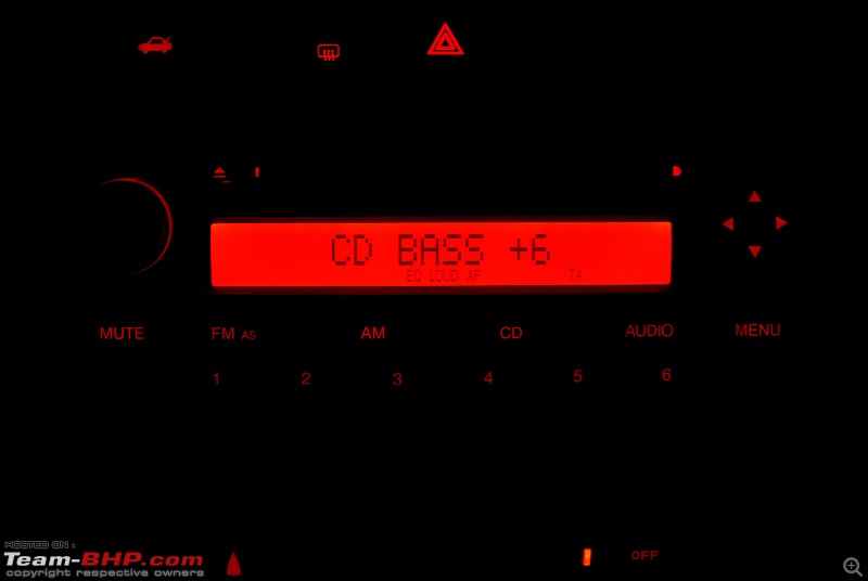

Also I am not liking the music system. Although clarity is good, the low frequency notes are muffled. I could live with the maximum loudness(without distortion) it offers, but the frequency range is not at all acceptable especially towards the lower end. I had a look at the 'In car entertainment' section, but I thought the suggestions given there were too risky and might void the warranty. Any ideas on this .
Hi,
Did you try the personalised - bass / treble adjustments and see if you get close to what you like?
Cheers, Sam
Yes the stabilizer bar is also known as the suspension linkage.
About the music system, there is a way to adjust the equalizer. My elder bro has adjusted it in my car. I shall ask him how and update.

Thanks guys, I have already personalized the equalizer and bass/treble settings. The settings are given below. Even with these, I am not able to squeeze out some low frequency response. I was wondering if upgraded speakers driven by the stock Blaupunkt HU would do the trick.

@UKR. You have taken the treble wayyy down. I think with stock speakers, low frequency reproduction is not very good. You might need to add a s/w. Adding a s/w however, is a tricky thing in Linea/Punto. Next best option is to upgrade the stock speakers with better ones.
But at higher treble levels, it is drowning what ever bass is audible now and is sounding more like a pocker fm radio.
What is an s/w?
Regarding speaker upgrade, will the stock HU be able drive them? Will it void the warranty?

UKR, I suggest you go through Pranav's thread in ICE section. Stock HU does not have a line out or a pre out so it is not possible to connect an amp directly. (s/w = sub woofer). In Pranav's thread, there are some solutions that he came across. I think all your queries will be answered there.
Edit: Any latest Linea owners: Can you confirm whether the HU is Blau or JVC?
