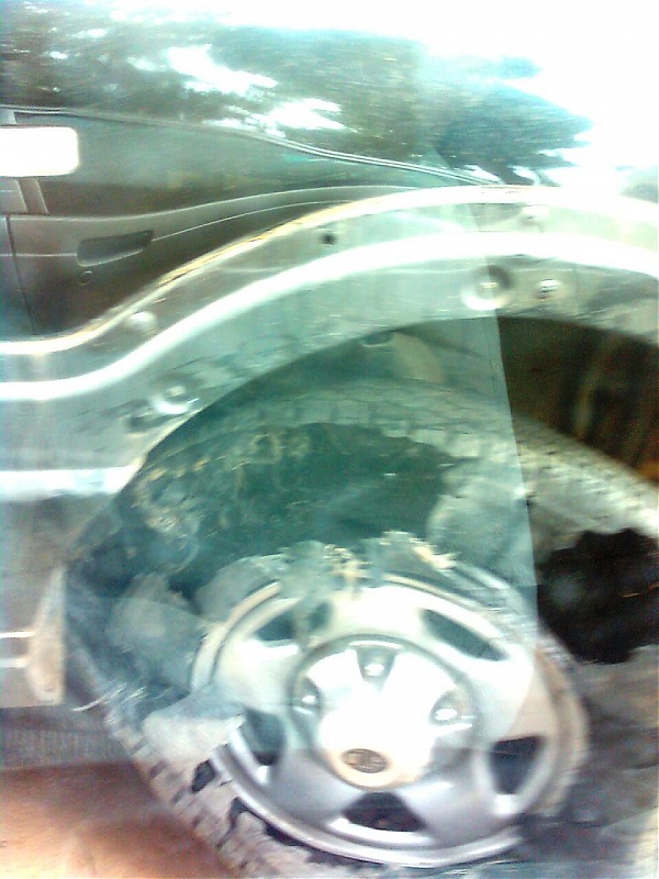

Just wanted to share a recent photograph of a tubeless Tyre blowing off on a new Tata Safari , I am amazed & could not comprehend how a tubeless Tyre (Bridgestone Make) can blow off to shreds like this, attaching a low quality picture taken of my mobile camera.

Lots of reasons.
If you were driving at a high speed and something on the road punctured the tyre, this could have happened.
If there was a bulge previously(maybe at an earlier date, you hit a pothole because of which the tyre cords were weakened at a certain point) and then another minor impact at the same weak spot could have resulted in the tyre giving way.
Could be a normal puncture(not due to a nail or anything, but maybe a piece of glass which cut the tyre) and since you were at a relatively high speed and took a few extra seconds slowing to a standstill, the tyre would have disintegrated.
Maintaining wrong pressure(maybe too high a pressure).

That tyre failure is not the result of solely a blow out. The condition indicates that the tyre has been driven in a deflated state for a quite a long distance leading it to shredded apart that badly.
