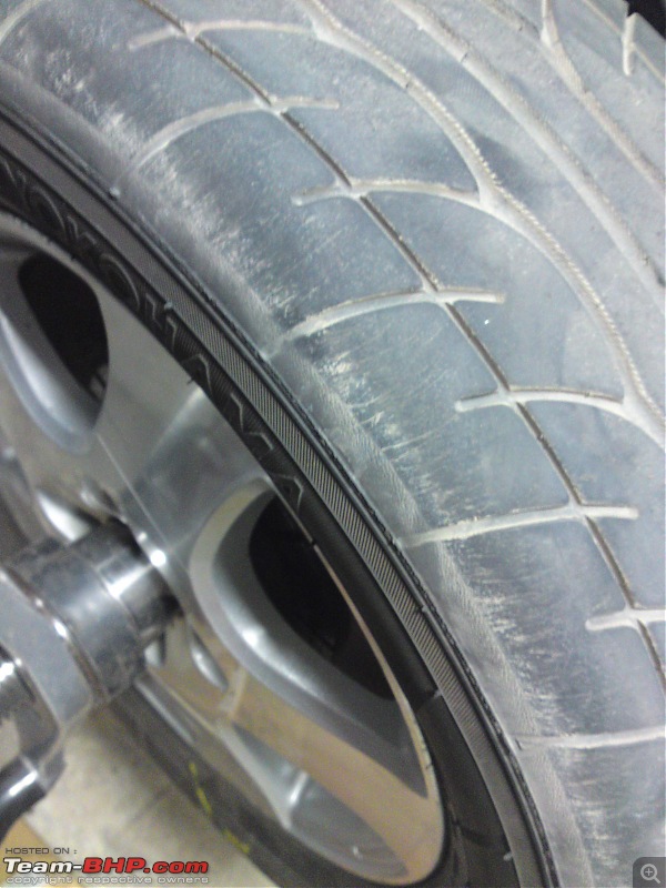

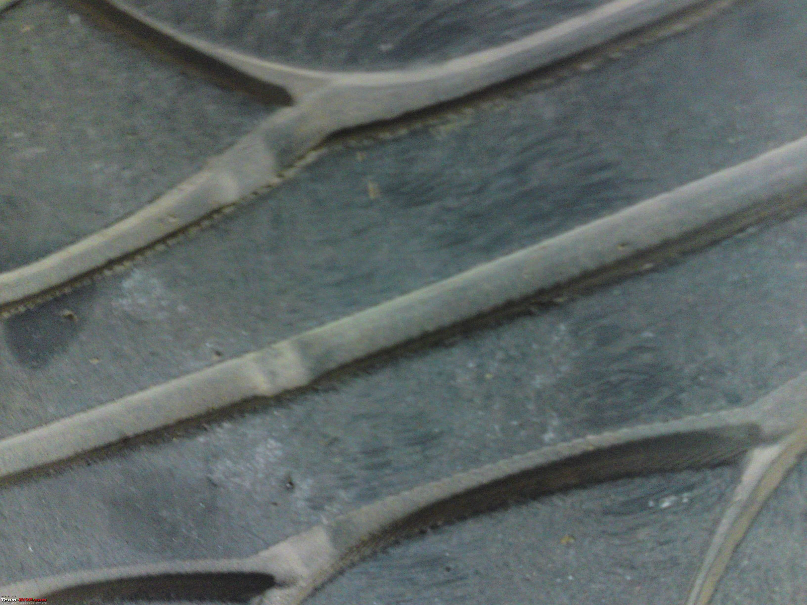

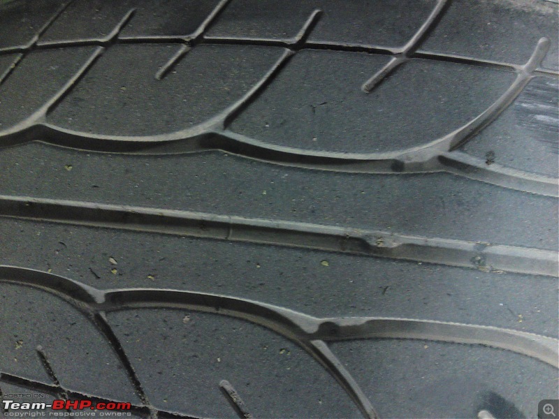

21,000 kms and 150 kms on the track and there is enough life left for at least 2 more trackdays or 5,000 kms.
Sure, the sidewall of one tyre (the front left) is scrubbed pretty badly, but that's nothing.
These tyres held up extremely well to the track day. Hardly any sign of uneven wear. There are some scrub marks on the sides of all 4 tyres, but nothing too bad.
Do check out the amount of tread I still have left. I'm absolutely delighted with the way these tyres have held up.
If you see the ES100s of Rahul's Palio, it has done around the same kms as my car and 1 trackday but the front tyres are completely gone.
Also, my tyres held up not only to 150 kms of ridiculous driving but at least 8 spins on the track at more than 100 kmph. It's simply staggering to see the way these tyres have coped.
