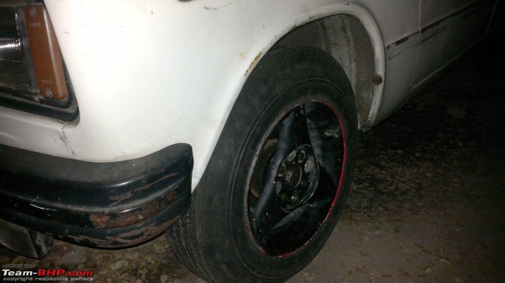

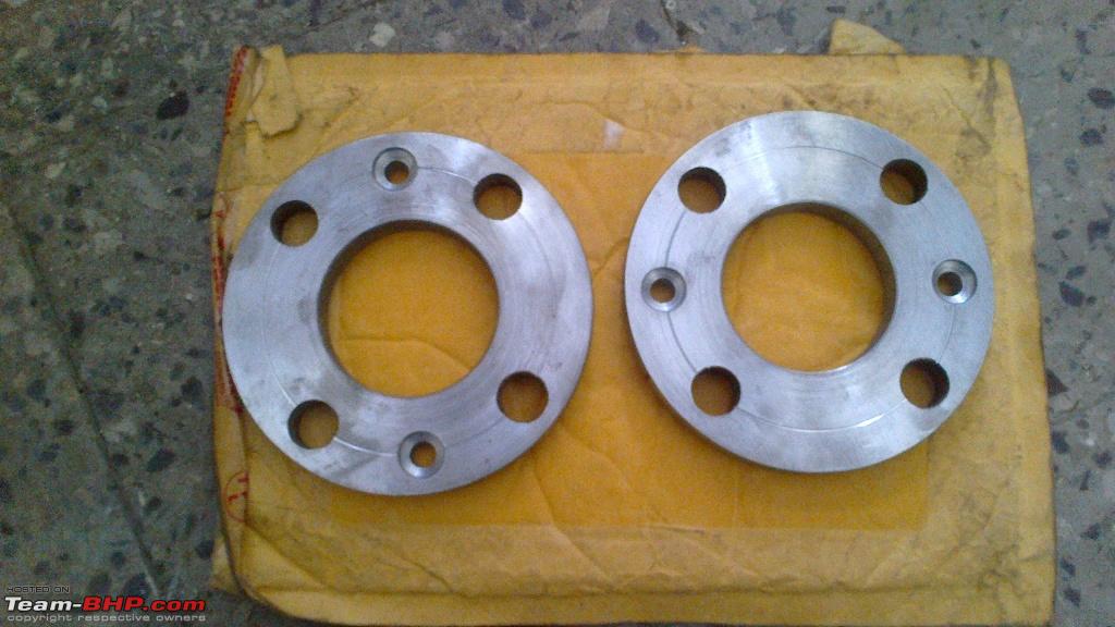

Originally Posted by riturajsharma19 View Post
Reviving an old thread. I have just procured a set of League alloys for my Punto. Now the centre-bore size of the alloys is 73.1mm while the hub size for the Punto is 58.1mm, requiring hub-centric rings of 78mm outer dia and 58mm inner dia.Suggestions solicited
Dear Rituraj Sharma,
It has been always a trouble in finding alloy wheels for Fiat vehicles due to their wierd PCD pattern. If at all you find one, matching the hub dia is again a problem. This is what I did in my 118NE. Grabbed a set of 5nos of 13" - 100 / 114.3 PCD alloys for a cheap price from OLX. The hub dia was 62 mm. Took the help of a lathe guy in the neighborhood who fabricated 5 adaptor rings for just Rs100 each. The matierial he used was a high pressure grade seamless tube. I guess it is used for some steam boiler or heat exchanger. As a result, rust hasnt showed up so far.
I brought the rings home, applied some oil on the inner side of the hub and outer side of spigot ring, hammered it with a mallet. Job done.
To match the PCD mismatch, I used wobble washers. Actually machined out the threads from the wheel nuts of M-800 and reduced the height of the nut. Used this as wobble washers and used SS washers on top of them.
To match the offset as per the 118NE specs, I had grabbed pipe flanges which already had 4 holes at 98 PCD. Only trued the centres, and fitted the alloys.
Coming to your problem, you have to install spigot bushes. It doesnt need any high level of expertise. Any lathe operator can do it for you. Only thing is that you have to specify the dimensions or take the car to him. Explain him that the bush needs to be tight fit on the alloy wheel and smoothly slidable on the vehicle side. If required, you will have to take pains in procuring the material as well.
Ilango

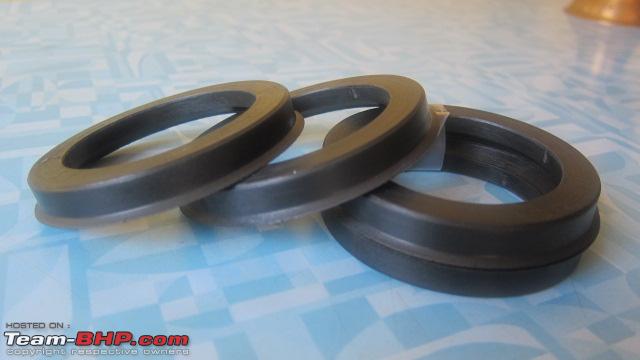

The rings were delivered to me on 14, Aug. The shipment reached me in just 6 days!
Got them installed the next day and they are a perfect fit. Am happy with the outcome.
Here are a couple of pictures of the rings:

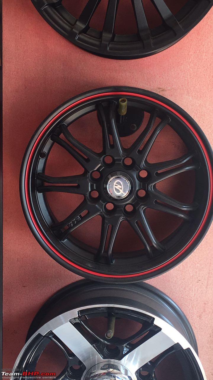

Guys I got installed 14 inch Neo alloy wheels for my TataBolt. Also got wheel balancing and wheel alignment done.
I could definitely notice an improvement in pick up and it's great.
At 110 to 120 speed the steering would vibrate and I was worried.
I reported the issue immediately to the wheel balancing guys and they ask me to get the car to the shop. The guy wheel balanced the tires again and guaranteed that there would be no vibration even if I drove the car at 160 speed now and was confident in his tone.
And there was no vibration at 120 speed as suggested by the guy.
The problem seem to be disappeared and maybe it was the fault the wheel balancing not being done rightly.
Same night I happened to read about the hub centric ring article in the team BHP site and I was surprised.
This morning I went to Ashoka wheels and one of the guys from the shop by name Amir suggested that 14 inch alloy wouldn't require hub centric rings and he even showed that there was only 1 or 2mm inch gap and ring thickness to 1 or 2 mm wouldnt last long and the Car should ride fine.
Please can someone suggest is that 1 or 2 mm gap absolutely fine?
