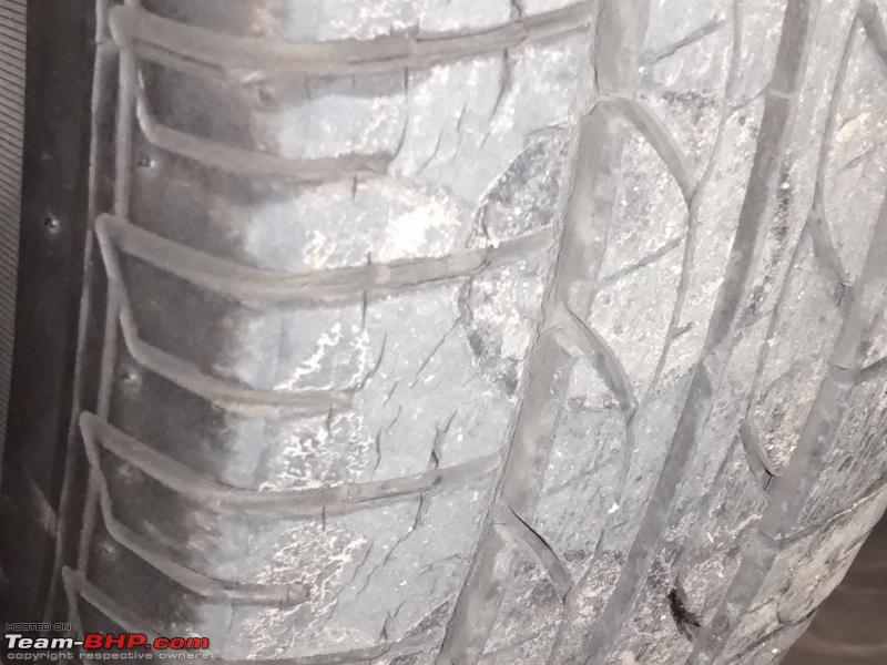

Friend, I went through the complete thread and had made up my mind to replace all 4 tyres of i10 (still running OEM tyres from 2010, done 16k kms) as I am planning for a long trip. However, was surprised with the feedback I got from Service Advisor (SA) and Tyre Dealer.
I had given my i10 for service yesterday and asked SA for his opinion and he mentioned that the tyres look good and surface cracks are normal. Unsatisfied, I went to Michelin dealer and I was sure he would be keen to sell new tyres. He mentioned that there are no side wall cracks and surface cracks are normal and you can run for another 5k kms easily.
Now I am confused. I am attaching few snaps. Let me know your thoughts.
His opinion could be based on tread wear & probably right. But, key question would be how many more months for covering those 5k kms.
Now I am confused. Let me know your thoughts.
16k Kms in 6 years shows minimal usage. Please change tyres just due to age. If your usage is going to be similar, please continue with Bridgestone (same as OEM). Michelin XM2, Yoko Earth1 would not make sense as your usage is less.
Are these kind of cracks across all tyres & only on outside? Is wheel alignment done at regular intervals? Cracks are appearing even on grooves.
Thanks. Yes, I am also inclined to change tyres due to age. Any reason why you are not recommending XM2, Yoko Earth1. The OEM one is BridgeStone B250. I was looking at B290 and XM2 and difference in cost is not much. Yes, the cracks are across all tyres.
It's mainly due to low usage in your case.
We have examples within forum on both sides e.g. Michelin XM1 showing cracks in 11k kms in 4+ years whereas person like ParagSachania having clocked 68k kms in less than 3 years & those Michelin XM2 still has another 5k life in them.
Although issues with XM1 have been largely solved/bettered in XM2, but my preference would be non-soft tyres if usage is going to be low.
You need to check the internal of the tyre. I changed my tyres that had a MFD of 4 years ago even though I had covered only 15k kms. They looked good on the outside however the insides were ruined and one of the tyres had become leaky too.
Do check the internals and then take a call if you need to change it or not. Although if you do change, your ride quality will improve greatly as the rubber on your aged tyres is substantially harder than a newer tyres
