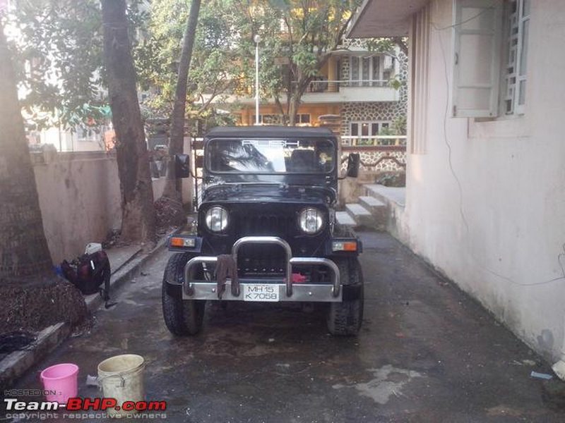

• Park your car nicely. Not everyone has the luxury of a covered garage, but even on public roads, you can pick a spot that is shaded (continuous sunlight is harmful), away from crow-infested trees (to avoid poop on your car) and safe (people not messing with it, no wannabe cricketers around, no couples using it as their love spot). Cost = zero, benefits = innumerable.

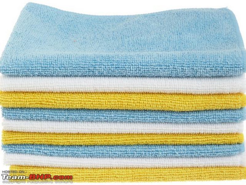

• Use only a microfiber cloth to wash your car. It's cheap (Rs. 150 - 200 each) and has many advantages (soft, non-abrasive, deeper cleaning, absorbent). It's a no-brainer, there is no reason for you not to use a microfiber cloth. Throw away whatever rag you currently have and buy some microfiber pieces online (3M or Meguiars are recommended). Buy at least 3 of them in different colours; one each for the exterior, interior & drying. Yes, you absolutely need a separate cloth for drying, it helps in preventing swirl marks. Give some basic training to your domestic help / car wash guy / driver. A 'tip' to pay special attention to your car goes a long way. Remember to tell him to properly clean your rims & tyres (regular cloth here is okay) and NOT to rub your car with a cloth when dry (it'll cause scratches). Also, don't wash the car when it's hot / under the blazing afternoon sun.

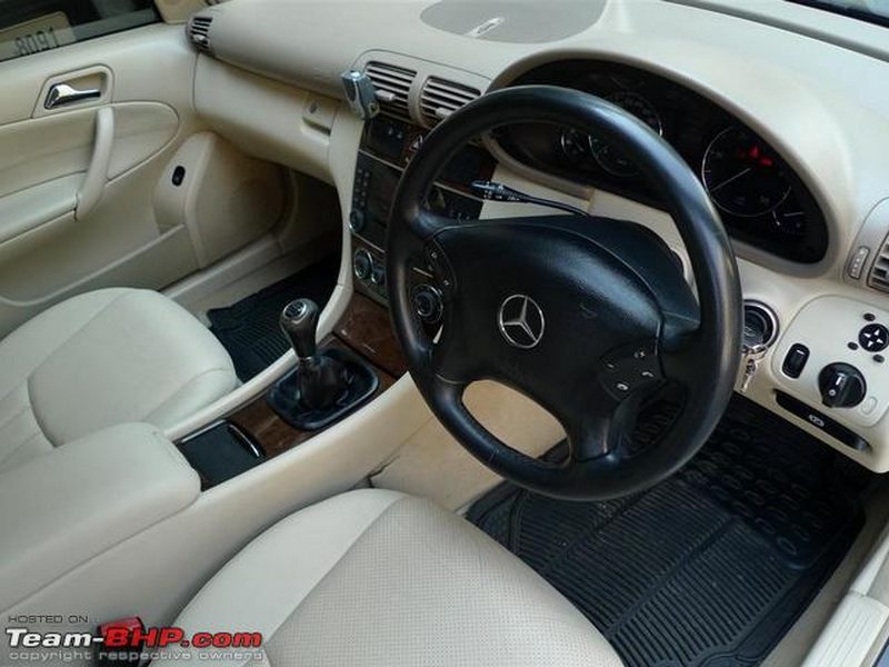

• Don't eat in your car & don't treat the interiors or boot like an attic. Cleanliness is next to Godliness. While on it, remember to clean the boot (and bonnet area) ever so often. This was my interior after 60,000 kms.
