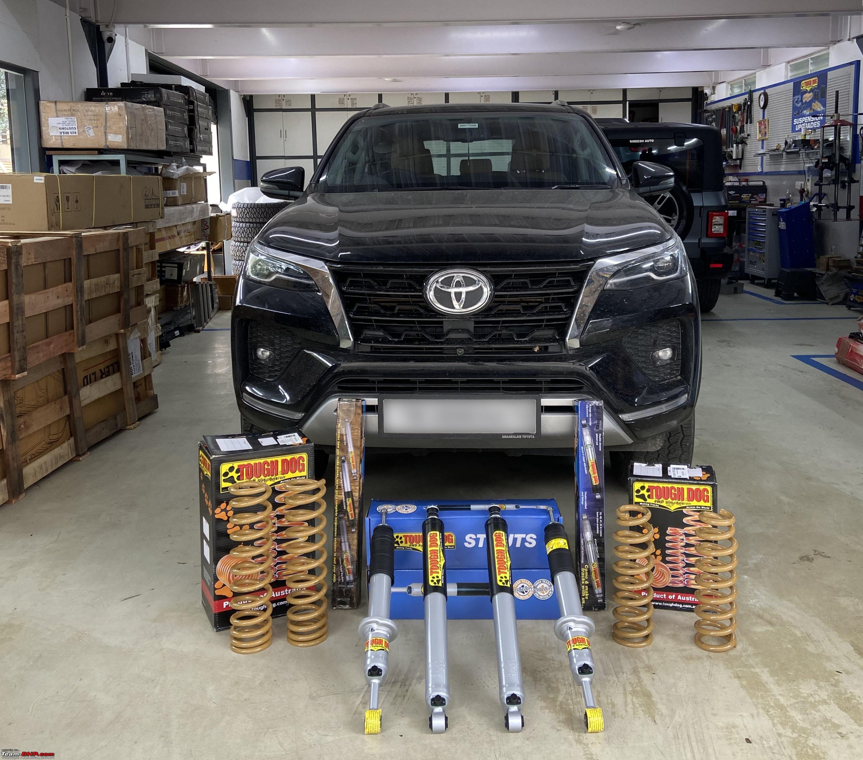

Update on the Fortuner suspensions:
Last week, I installed the Tough Dog Foamcell Pro suspensions in my Fortuner. Got the installation done at 6th Mile Customs in Bangalore, who are the dealers for Tough Dog.
First impression is very good. These offer a very significant improvement in ride comfort in the softer settings, while keeping the high speed handling at highway speeds good.
I have documented the installation and experience with these suspensions in detail in the below thread.
Installed: Tough Dog Foamcell Pro Suspensions in My Fortuner 4x4 AT
