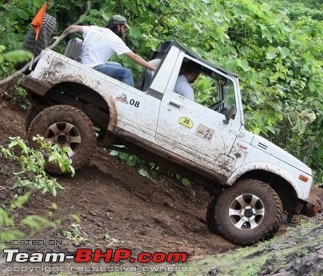

Originally Posted by Samurai (Post 1175714)
In my experience GV being a IFS 4WD is a much better trail or bad road vehicle, way superior to solid axle CJ340. But when it comes to rock crawling and offroad hill climbs, the roles reverse completely. On bad roads CJ340 can follow the GV, albeit much slowly. But when it comes to rock crawling, slush or hill climbing, CJ340 leads and GV can't even follow.
Sorry but came to this thread late. The point about IFS is also for what level of articulation it has been designed. GV's not been designed for too much articulation. DKG mentioned some video's that show really huge articulation with all wheel IFS.
