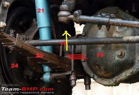

Ok, I was thinking of the below logic (pic courtesy Sharat's jeep). Wont adding 3 leafs' to the existing 8or9 make the diff(whole axle) go up?
(Sharat, pic from the opposite angle showing the U Clamp will clear this doubt)
Raising a Jeep's ground clearance : Options?-9-3.jpg
I doubt that it will make the difff go up but on the contrary the diff will remain where they are and by adding the extra leafs the lower most leaf will come down by the exact thickness of the extra leafs that you put in extra. This is my opinion though, lets wait for the comments of experts!
Santosh, you will wonder that the same thing came into my mind but when I told the machanic to do this mod, he explained me in detailed. Harjeev is right. It will neither increase your ground clearance, nor will lift the body. Better go for longer shackal.
Attachment 253050
In this case, the axle will go up only if the tyre is willing to float in air.:)
Look at it again. The tyre is grounded, the axle is firmly attached to the wheel. So the axle will remain where it was.
Yeah,the axle will go up, pushing the rest of the body down.:D

on contrary, the body will come down by few millimeter(by the thickness of the spring pack), reducing the vertical space under the mudguard. agree:
Why should the body come down?

because the body is attached to the springs!
Keep the axle as the datum. And you are adding 1 inch thick packing below the OE spring & axle.
So the spring mounting point moves down by 1 inch with respect to the datum.
Naturally the body & chassis, which is attached to the spring also will move down by 1 inch.
Whatever you are adding (leaf or packing), you are adding below the main leaf, which remains the topmost leaf, right?
Sutripta
