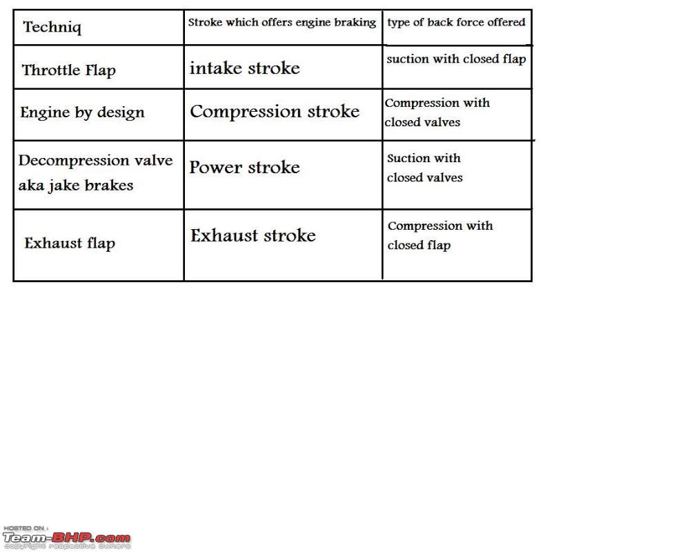

a small table explaining the techniques and its usage.
usually the heavy duty trucks will have combination of the above techniques for effective control.
Attachment 281448
>> Yep.
