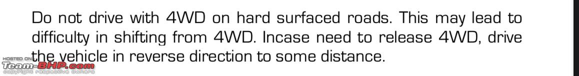

Found this in Thar’s manual. Can reversing after disengaging 4WD help release windup?
Driving all four wheels: how is it done?-c4f1b504853f4aa2ab2a692c157855a5.jpeg
