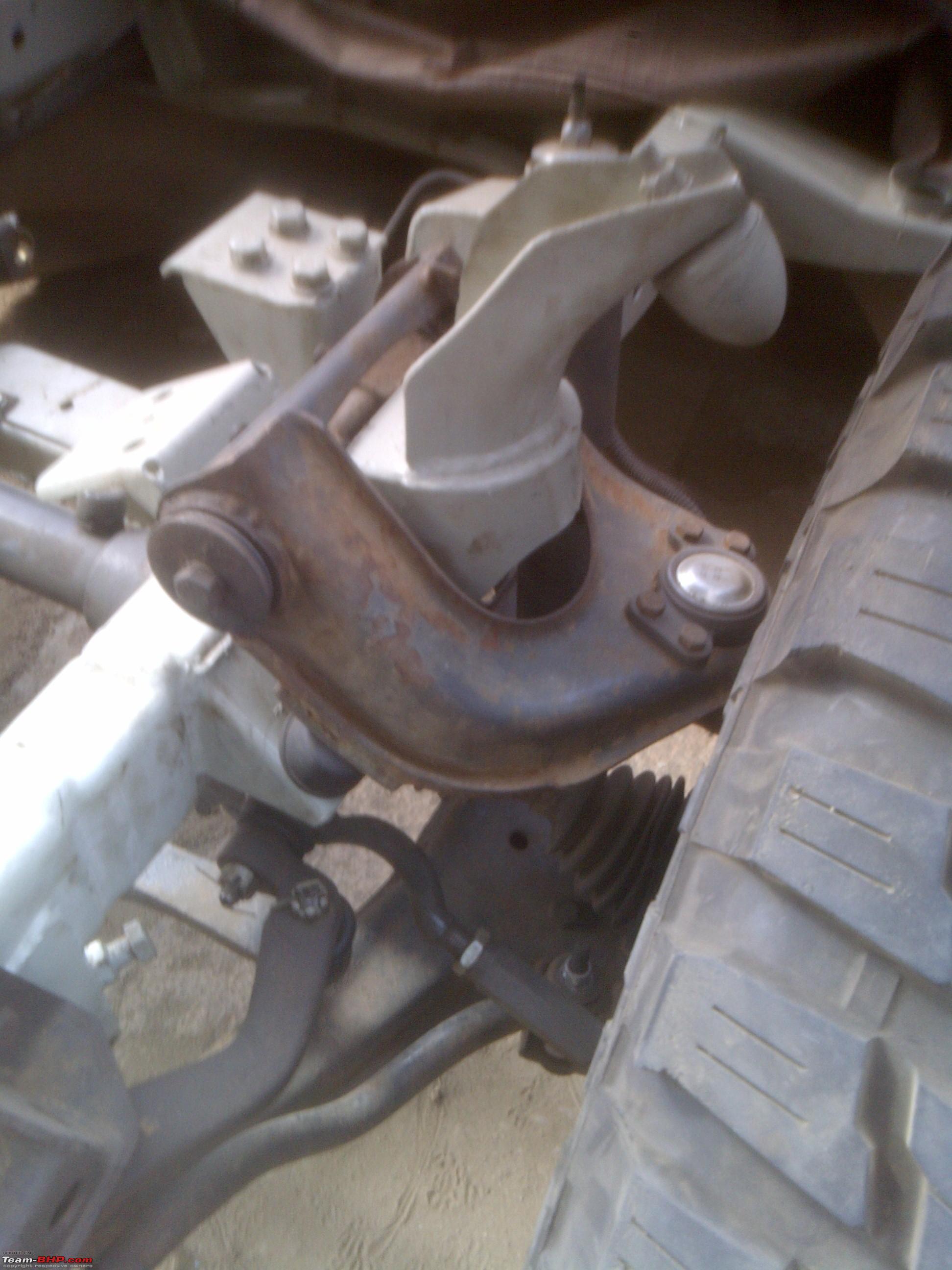

Re: New 4X4 project

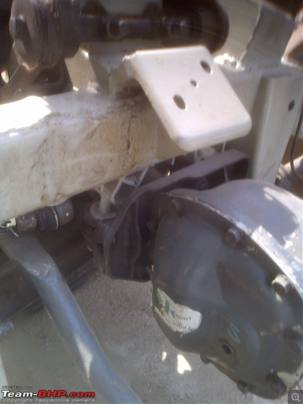

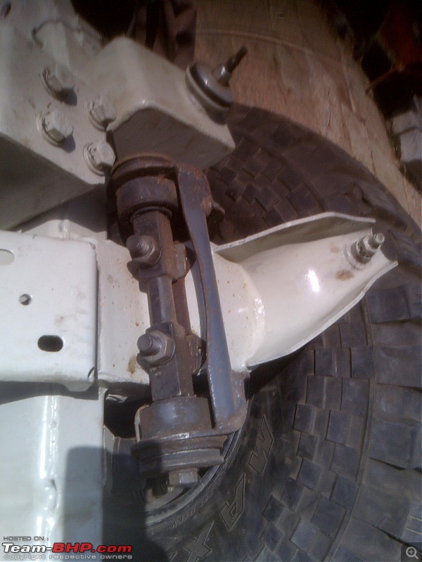

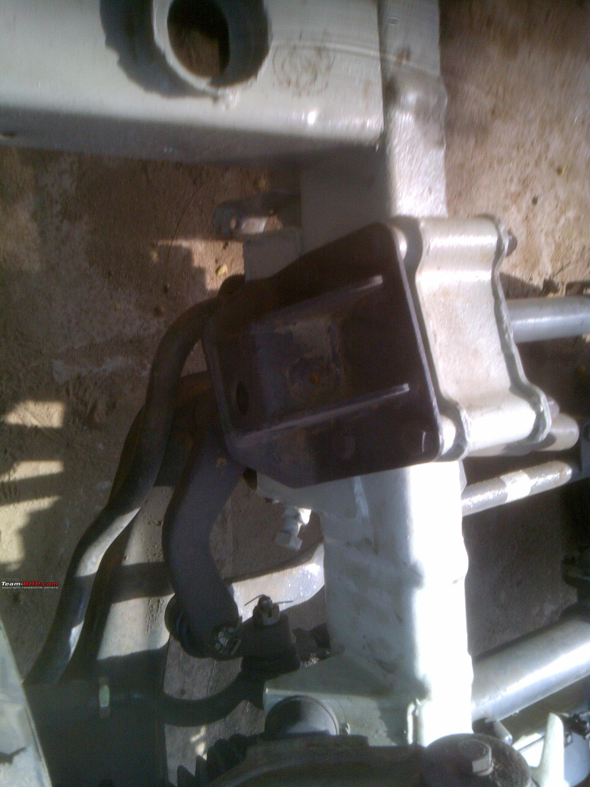

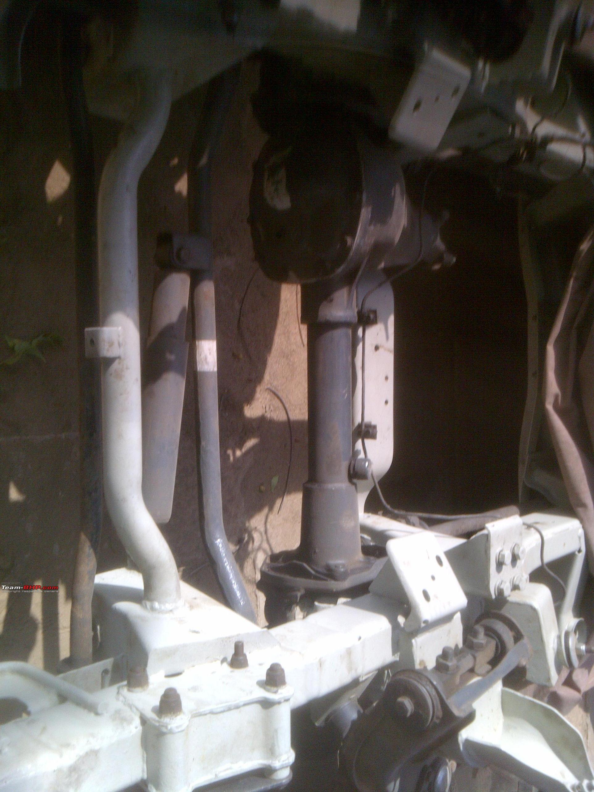

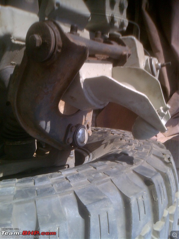

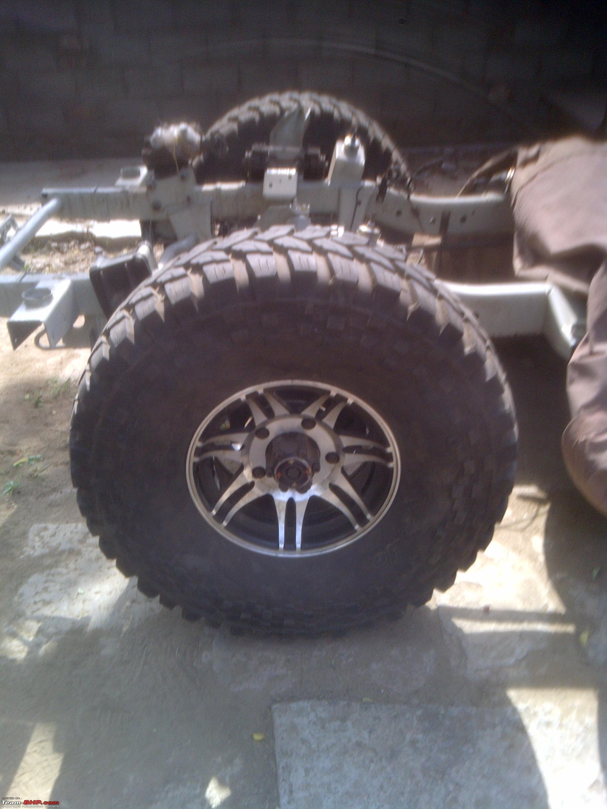

Some pics with 35" tyres fitted and random suspension pics.
Engine and gearbox still not procured.
Joyeb:looks like a transformer in the making!!! BTW are those TATA Sierra suspension? Are you completely planning for a coil over suspension?
What are the plans for the critical parts?? What combo have you finally decided upon?
The whole project is based on Safari underpinnings.

What axles are you running and what dif ratio do you plan?
Keep in mind the torque generated by the the 14B turbo and the weight of the 35inchers. I too had considered 35s but settled for 32. I've also put a 14B NA in my project.

I am using the Safari axles. The diff ratio is 4.55:1.
Where did you get the 14B engine from? I could use a supercharger along with it. What do you think?
If the axles on the old Safari (TCIC) are the same as the new (2.2/3.0) then am sure you'll be able to use the Safari axles with even a 14B-T as torque generated should be in a similar range (300+Nm)
Based on what I found out, its easier to find a 14B as those were fitted on those DCM trucks but finding a 14B-T is way tougher as that is probably an import.
Will ask about the Safari GB/TC and let you know.
