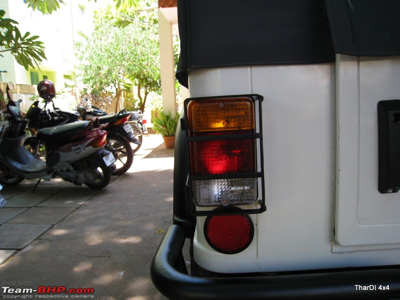

Adding some more pics. Please not that I am not showing off my vehicle, but Thar DI 4x4 is a rare animal and just adding pics for the benefit of people who live in BSIV cities who do not have access to info on Thar DI 4x4.

10) Rock Sliders, Headlamp, Turn signal, & Rear Lamp guards from RogeoTech
