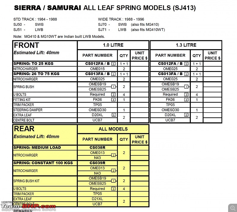

The front setup indeed has different Springs and even different U Clamps. FA is on the left side and FB is for right. If we check the old sales quote from here-
http://www.team-bhp.com/forum/4x4-ve...ml#post2204683
even that has a different setup. Just that ARB does no longer recommend the old 034 shocks.

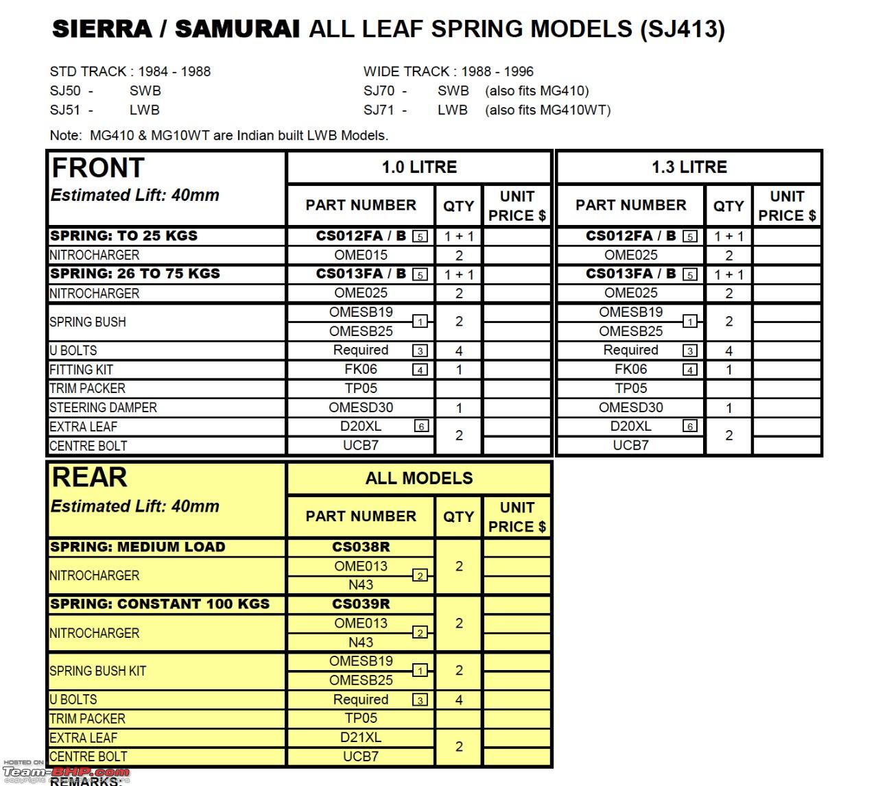

Here's the complete information.
Unfortunately, I was not aware of this before and don't know if we have installed the correct ones on the respective sides. ARB Dealership should have explained clearly or even packed the contents as front Left/ Right. Hope my installer had spoken to ARB guy during installation.
Regarding rear, as pointed out by Mr. Vikram, ARB has indeed supplied the one with 100 Kg constant load. They have told me to try using the existing one with some load and check if it gets better, in which case they will order medium one for me.
I feel they should have told me this beforehand especially when I had asked them specifically to give me the medium one (they don't produce the standard for the rear which was told at the time of ordering)
I will update the outcome here.

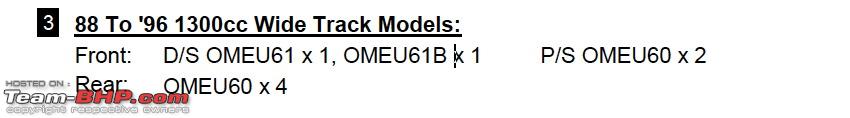

Originally Posted by Vikram Arya View Post
Ideally, either CS012FB or CS012FA should have been used & not a mix of the two different load rated springs.
I'm also curious as to why heavy duty springs at the rear which are rated for a 200 lbs of constant load were used and not CS038R which are medium load rated springs & would have better suited the application
Completely agree with all of the points above.
Mr. Vikram, can you share the link where we get this information and also can you check if the shocks are correct?
I have been doing some research on this front since I plan to switch over to OME suspension setup for my Gypsy very soon. When asked for a quote from the ARB distributor here, I was given a similar list of parts and could not get a convincing answer to my query regarding the reason behind use of 2 differently rated leafs in the front. He has reached out to ARB AUS on this and will get back to me by tomorrow.
I am of the understanding that if one does not plan to install a heavy front bumper along with a winch OR use the Gypsy for hauling really heavy loads, a medium setup for both front and back should be just fine. Also note that shocks are the same for all ratings of leaf springs, for front and back respectively.
FYI - given below is a snippet from ARB website, detailing the specs for Suzuki Samurai suspension. Hope this helps...
I am still not convinced. Why would they be different, unless the load on the front of the Gypsy is heavily off-set to one side (which does not seem to be the case, at least visually)?
I will agree with you but there must be a reason, I have posted a link from 2010 where some European guy have also offered similar configuration so let's wait for an answer.
Here's another site which has used the same configuration
http://www.4x4proyect.com/parts/old-...-kit-suzuki/en
Can you post the link to the ARB site from where you got this information?

Heard back from the OME distributor today. They had reached out to ARB on this and the response is - front LH and RH leafs are indeed different for the Gypsy King 1.3 lit model, given the slightly uneven weight distribution across the two, primarily due to the engine being offset to one side.
Turbanator - can you confirm this (the reason, that is) once with your guy as well?
Yes, the same reason.
ARB Dealer is trying to get my medium load rating springs by Air in next consignment
Turbanator is online now

Thanks, Mr. Vikram for the details, after cool_dube had pointed, I tried to google but could not find the difference.
I have dropped the message to ARB dealership.
Here's the ARB USA link: http://www.arbusa.com/Vehicle-Application-Guide.aspx
I'm also enclosing the pdf for your ready reference.
Thank you very much for clarifying about different load rated springs for the front left & right side. Going by your feedback even I'm tempted however having put 3,800 kms in two and half years I don't know if it's worth it.
Please advise if there's an OME distributor in North?
On a side note when I'm back towards the end of the year (I normally land at CHD) you would be kind enough to take me for a short drive and I can evaluate the difference from the stock set up.
Again congratulation and enjoy your new ride (now much more comfortable).
