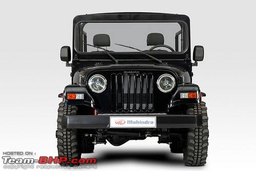

My dream jeep is getting ready with SZ2600 chain drive.
So finally it's happening! Good choice of engine too. Are you sticking to KMT or NGT530?
IIRC, the SZ redlines at ~3500 rpm so you may need a change of crown pinion too.
Looking forward to your post transplant experience.
