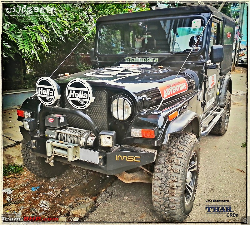

Phew! That turned out to be a lot longer update than what I had originally thought of. For now, let me just finish this bulletin with a picture post installing the limb risers. :)
Is that rust on your lower-arm?
Originally Posted by vivekjayasheel
(Post 3239655)
Is that rust on your lower-arm? |
Nah, not yet. Its just dirty with all the mud from the potholed city of Namma Bengaluru :)

The limb risers are steel cables running along the side fender which help in deflecting tree branches away from the windshield while driving through thick tree covered trails. Since I use a camera on the windshield it will help in keeping the line of sight free from distractions and also save it from some random hits which it has endured so far. The only thing it won't protect is from branches hanging from above which is still a risk.
