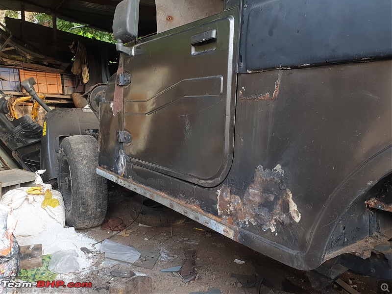

3) Later during 2020, the lockdowns and other related pandemic BS meant that there was enough time for a full body tear down and rebuild. Years of being in the salty air of the coast had taken its toll, causing a rattly, squeaking body.
Hardtop MM550 : A family friendly offroader joins Team-BHP-20200606_151407.jpg
Hardtop MM550 : A family friendly offroader joins Team-BHP-20200608_171353.jpg
Hardtop MM550 : A family friendly offroader joins Team-BHP-20200609_172848.jpg
Hardtop MM550 : A family friendly offroader joins Team-BHP-20200609_183325.jpg
Hardtop MM550 : A family friendly offroader joins Team-BHP-20200612_163209.jpg
Hardtop MM550 : A family friendly offroader joins Team-BHP-20200908_090156.jpg
After several months of being in the workshop, the MM550 has been reborn as a black beauty - for now :)
