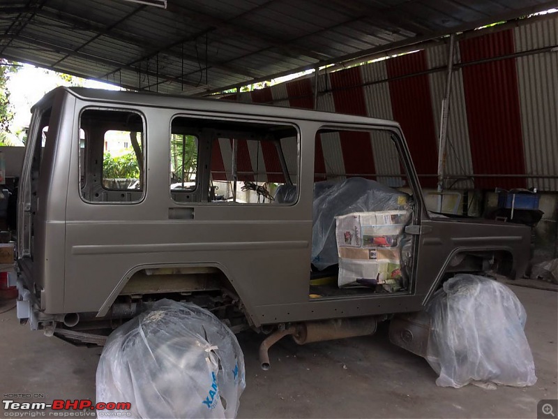

The original build quality of body works in Gurkha is pathetic, Rameshan and his team at Marvel Auto was found very much excited and highly involved with this modification works he has attend to every minute details, every weak or shabby body joints are reinforced and all the areas suspected to generate cracks are strengthened with mig welding. We tried to eliminate vibrations and rattlings as much as possible.
All the body panels will be sanded as much possible and start with applying marine grade anti rust body primer and sealants.

Painting jobs progressed very fast, if fact much faster than i expected. I was also in a hurry to see the color outcome and the project being approaching to its final stages the body shop team also found in hurry to see its final appearance
Force Gurkha: G-Wagen Makeover-21-2.jpg
Force Gurkha: G-Wagen Makeover-21-7.jpg
Force Gurkha: G-Wagen Makeover-21-8.jpg
There was many suggestions came for the color selection and the most recommended was 'white' however i wanted to try something different and opted for grey and it didn't disappointed at all, really delighted to see the final color outcome, exactly as i expected and to the taste
