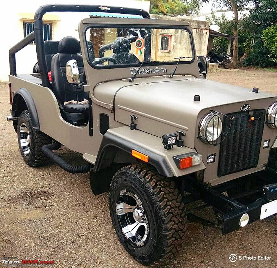

Colour
The colour of the Jeep planned as of now is this. I have chosen the picture from open source
Bought a 1970 Mahindra Jeep (CJ500) | Requesting advice and guidance-3-1.jpg
Good choice. This color won't show dirt and dust so much and it is smart looking. Try to get a similar color and hue without mixing at all. This way if you have to repaint something later you can buy the same paint color without as much trouble trying to match the existing paint.....with luck.
Hi Dan,
Thank you, man. I would have just looked at the shade and not thought about this aspect later, lovely foresight. The Jeep has gone today for the paint job. I will be insisting on the original shade.
