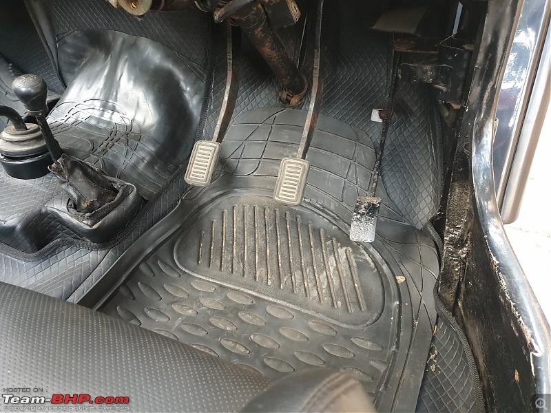

Sunil Shanbagh is really something else . I sent over the Jeep for a bunch of things to be fixed. Also wanted him to replace a section of the floor (driver's side) that had a hole in it.
Jeep came back today. Proactively, he has fitted this awesome rubberised cover / matting on the entire floor, including the rear bed . Best part is, I hadn't even asked for it, but I LOVE IT. Easier to clean, no scratches and might help with controlling rust too.
Sexy new cover all over:
Mahindra Classic 4x4. 2.5 Liter Diesel. Back on the road!-20190103-12.01.37.jpg
Mahindra Classic 4x4. 2.5 Liter Diesel. Back on the road!-20190103-12.02.32.jpg
New seat upholstery:
Mahindra Classic 4x4. 2.5 Liter Diesel. Back on the road!-20190103-12.01.53.jpg
Mahindra Classic 4x4. 2.5 Liter Diesel. Back on the road!-20190103-12.01.57.jpg
GTO is offline   (18) Thanks

...he has fitted this awesome rubberised cover / matting on the entire floor, including the rear bed . Best part is, I hadn't even asked for it, but I LOVE IT. Easier to clean, no scratches and might help with controlling rust too.
The floor matting looks great.
However, there is a risk in keeping this floor matting full time. It traps water/water vapor and the platform starts to rust. This is ONE major reason why platforms rust over time. I really want my Jeep interiors to be neat and I love these floor mats. The added bonus is it dampens quite a bit of sound. However, I try to put it on only when I go out with the Jeep. Whenever it is parked in the Garage, or in the workshop, the mat is off.
One thing that you can do, that will not work with me is to 100% rust proof the platform with whatever available coatings. Just overdo it (Once the surface is rust free), and don't ever drill a hole afterwards. And then use the floor mat, it will work better.

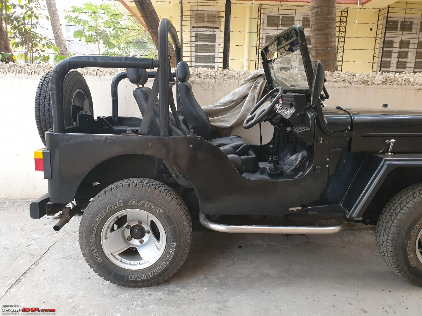

One thing I've realised with Sunil Shanbagh is that he's at his best when presented with a challenging problem. He loves tinkering & solving.
For 22 years, I've lived with a cramped seating position in my Jeep. Just got used to it, I guess. However, this time, since the seating position was messed up, I requested Shanbagh to also see if he can increase the legroom.
Well, he enhanced the legroom & how. Last night was the first time in 22 years that I could comfortably fit in my Jeep. For a guy who has a laid-back driving position & usually moves his seat all the way back, I actually had to move it ahead a notch (from the last position). Heck, even super tall Sam Kapasi would fit in my Jeep now related post. Shanbagh has gone and added over 6 inches of legroom.
Just look how far behind the driver seat is now! It's so comfortable that I actually took a super long drive last night after dinner, thoroughly enjoying the new found legroom. Downside = the seat is lower than I prefer & the bum support isn't how I'd like it, but will get this fixed at the next service. Want to enjoy the weather now. The Jeep is anyway like a big toy for me. It's got no utility value, nor any book value. Just a play thing that I use on nights & weekends:
Mahindra Classic 4x4. 2.5 Liter Diesel. Back on the road!-20190203-08.21.49.jpg
Shanbagh - being Shanbagh - called me and said he found the pedal position too high (it always was). He lowered all of them. Dare I say, the Jeep is a bit more car-like to drive now:
Mahindra Classic 4x4. 2.5 Liter Diesel. Back on the road!-20190203-08.22.19.jpg
Compare the left hand side to the right hand side. Notice how much metal has been cut to allow the driver's seat to move back. These are the kind of things you can only do in old cars, and why every Jeep out there is unique in its own special way:
Mahindra Classic 4x4. 2.5 Liter Diesel. Back on the road!-20190203-08.23.10.jpg
With the seat all the way back:
Mahindra Classic 4x4. 2.5 Liter Diesel. Back on the road!-20190203-08.23.52.jpg
The seatbelt buckle can no longer be mounted on the rollover bar!
Mahindra Classic 4x4. 2.5 Liter Diesel. Back on the road!-20190203-08.24.20.jpg
The protrusion (top right) looks ugly once you notice it, but I'm willing to live with it for the enhanced comfort. Reversed on a very tall footpath to test it and no, the tyre didn't touch it:
Mahindra Classic 4x4. 2.5 Liter Diesel. Back on the road!-20190203-08.24.53.jpg
